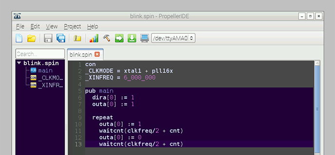

Propeller IDE
The weapon-of-choice software for writing Propeller SPIN is the Open-Source Propeller IDE. It runs on the Raspberry Pi pretty well, and we've made sure you can upload code right onto your Propeller HAT painlessly so you can get programming quickly and avoid the hassle of setting up.
The great thing about Propeller IDE, SPIN and the Propeller is that they're close-knit and unencumbered by the need to support lots of different processors. This makes compiling and uploading SPIN code absolutely lightning fast- Arduino users will be simply blown away.
