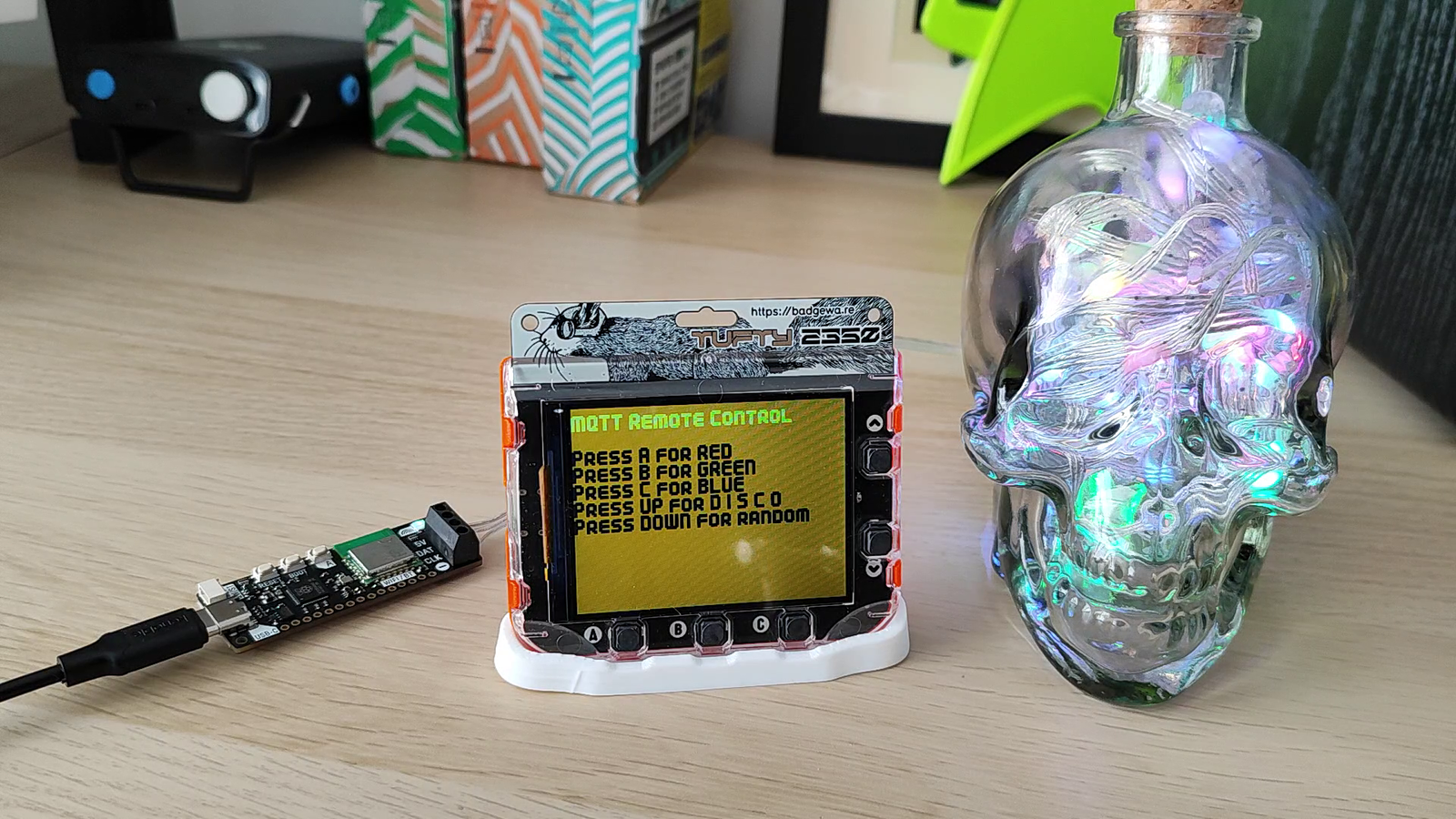

We're going to build a remote controlled chain of RGB LEDs using two devices. Tufty 2350, one of our new Badgeware devices and a Plasma 2350 W connected to a string of 50 addressable RGB LEDs, commonly called "NeoPixels". Because both boards have Wi-Fi capability, they can communicate with each other over a network connection.

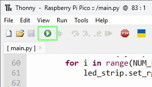

  1. Save the code as main.py and click Run.

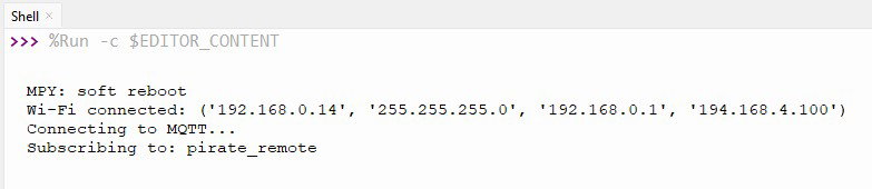

  2. You should see that Plasma 2350 W is connected and subscribed to the topic.

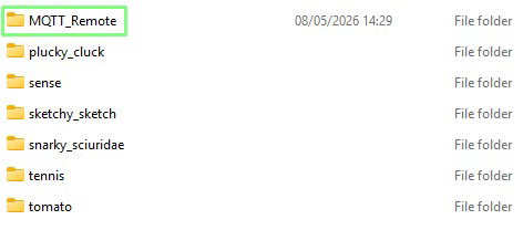

  5. Open the apps folder and create a new folder called "MQTT_Remote"

  1. Set the pen colour to black and then write five lines of instructions. Note that the Y value increase by 10 pixels for each line.
    screen.pen = color.black
    screen.text("Press A for RED",0,20)

  1. Save the code, close your text editor and then safely remove Tufty 2350 from your computer.
  2. Press Reset to power on Tufty 2350 and navigate to your app. Press Button B to run the app.
  3. Once the MQTT_Remote app has made a connection, press the corresponding key to send the message to Plasma 2350 W. You should see the RGB LEDs change colour. If not, reset Plasma 2350 W and then try again.
