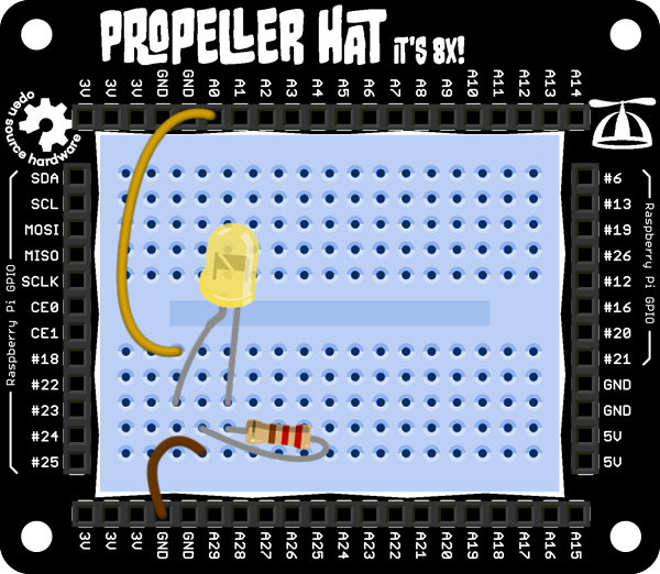

Well, that was an explanation marathon. Go and cool off your brain for a minute, and then get ready to compile and run your code. For this example you can use the same layout we used in the SPIN blink example:
Propeller Blink Layout
