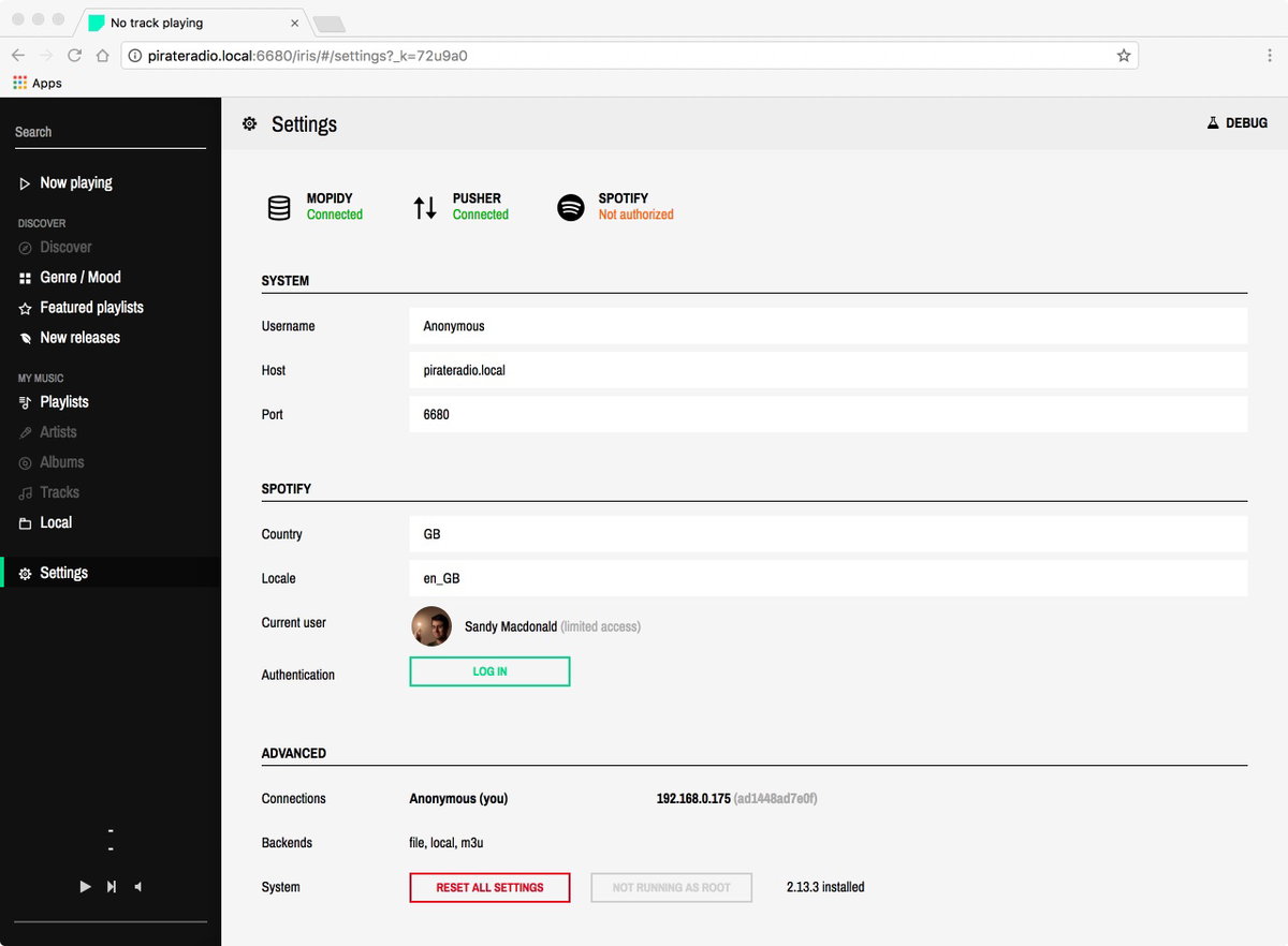

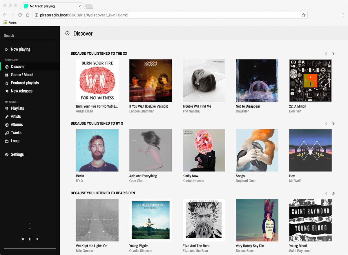

Your browser should have loaded up the Iris web interface. It's fairly self- explanatory to navigate, but one important thing you'll have to do is to go to the settings page and log in to Spotify, to authorise it, if it's the first time you're using it.
Click "log in", and it should pop up a new window to authorise Spotify. If it doesn't, then you might need to switch off any pop-up blockers that might be active. Now that you've authorised Spotify, you should have access to your playlists, and saved albums and artists, featured Spotify playlists, and more.

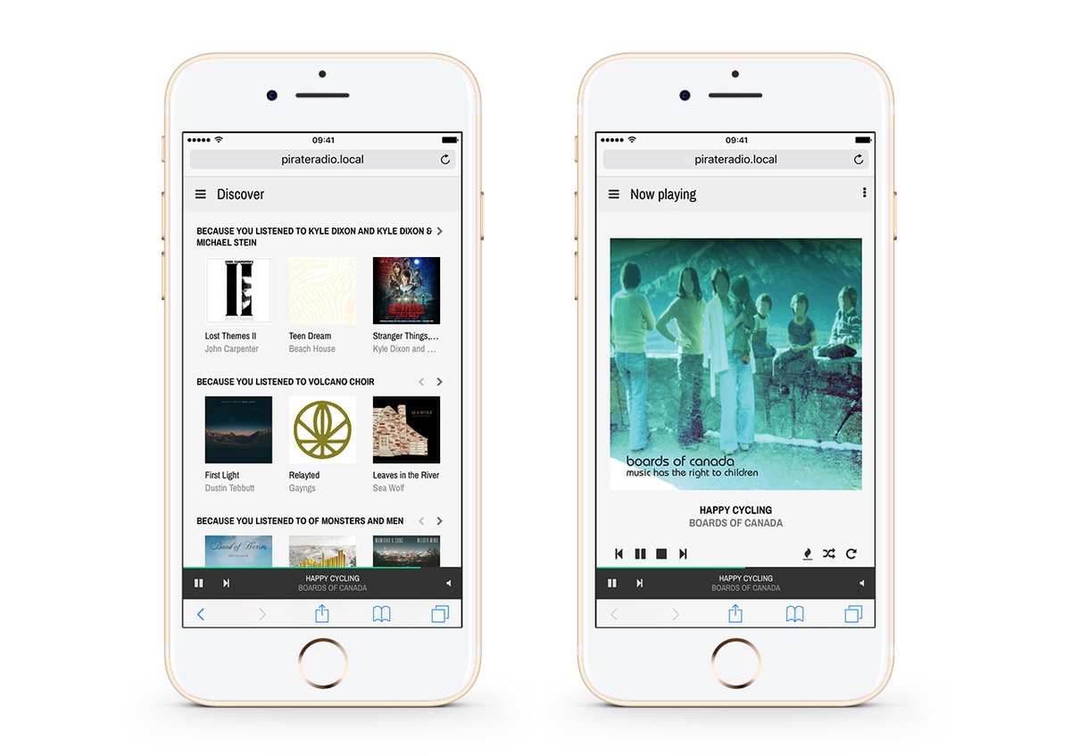

Because Iris is responsive, it looks really good on mobile as well, resizing and changing context to work on smaller displays. And because it's just a regular web front-end it will work equally well in iOS or Android.
