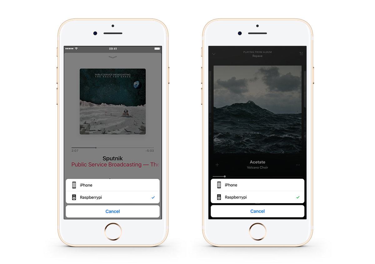

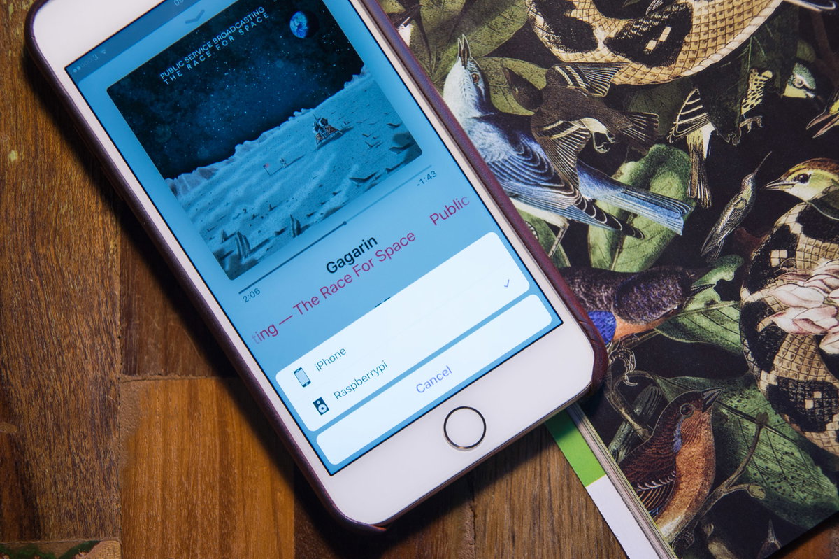

Assuming that worked, you should now be able to stream to your Pi from your iPhone. Start your music playing, and then tap on the Airplay icon and select the device that will have the name "Raspberrypi", unless you have changed the hostname on your Pi.
