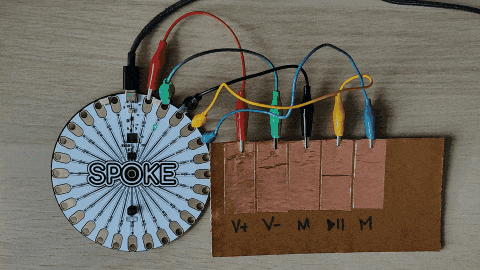

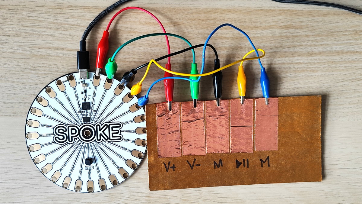

We've kept the build simple, just five crocodile clips, from inputs 1 to 5, connected to a length of cardboard which has copper tape stuck to it. The beauty of SPOKE is that anything that can conduct voltage, can be used as a touch input. From copper tape to bananas, even conductive inks, woven tapes and threads can be used to make wearable touch interfaces. Here is an image of our setup, adapt it and make it yours!

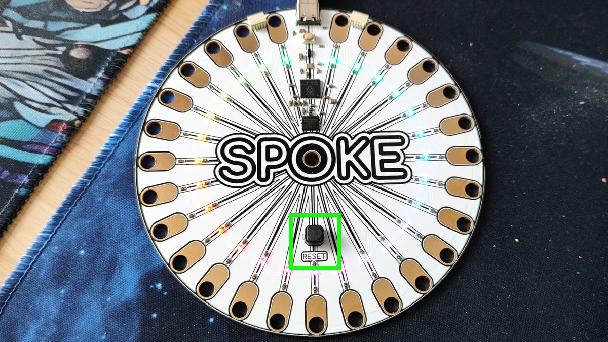

Remember, when adding / taking away a conductive object as an input, press reset so that SPOKE will recalibrate the input for accuracy. If you don't do that, your input may not work as expected.

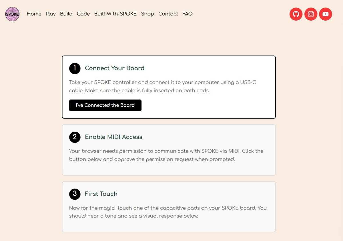

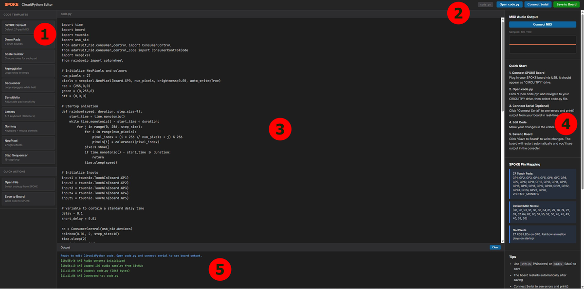

  1. Before starting this project, follow the guidance here to confirm that your SPOKE board is connected. Spend some time getting to know SPOKE, try out the many examples and learn how SPOKE can be used in your projects.

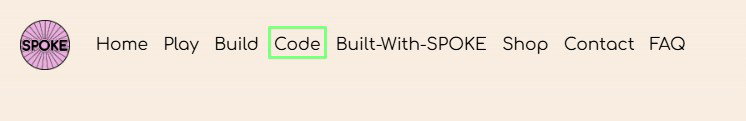

  2. Click on Code.

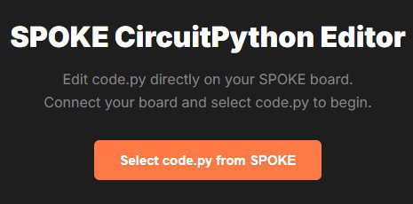

  3. Click on the red box to open the code editor.
  4. The code editor is broken down into five key areas.
    1. Code Templates: Pre-written code examples covering how to use SPOKE in audio, gaming and general PC keyboard projects.
    2. File / Board Operations: Open the code.py on your SPOKE board, connect to the Python REPL via a serial console (5) and save your project to code.py.
    3. Coding Area: Here is where we write the CircuitPython code.
    4. Quick Start / Help Area: Need a quick tip, pinout, or common library name? You'll find it here.
    5. Output / Python REPL: This area provides information when saving code to SPOKE, and a Python REPL (Read, Eval, Print, Loop) that we can use to interact with SPOKE.

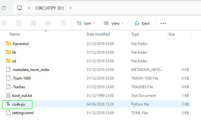

  5. Click on the button in the centre of the coding area (3) to open code.py on SPOKE.

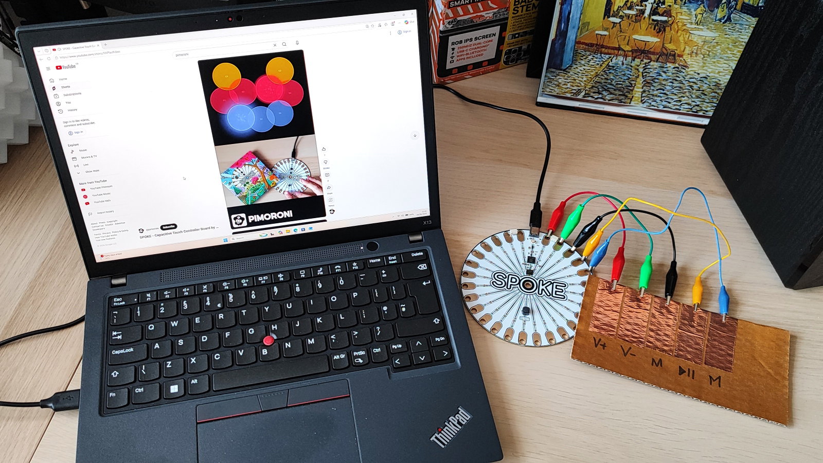

  1. Click on Save to Board. SPOKE will restart and the NeoPixels will light up to confirm that the code is running.
  2. Open this YouTube video and Press Inputs 1 to 5 and you will see the corresponding action happen. Input 1 is to the right of the USB C port and the inputs move clockwise around SPOKE.
