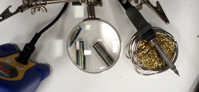

  4. Helping hands
    Don’t conscript someone to hold components for you, they get hot, really hot! A soldering "helping hand" is basically just a pair of crocodile clips and usually a magnifying glass on goose-neck arms. You can pick one up for about £8.
    Alternatively, if you’re an avid DIY-er, you can assemble your own set of helping hands out of heavy duty uninsulated crocodile clips and heavy gauge wire or re-purposed metal coat hanger. This is more of an academic exercise than anything I think would pan out to be useful, since a real Helping Hand is cheap and much more robust.
    The arms used in our helping hands are made from flexible water pipe - used for accurately positioning cooling jets at crucial places on an assembly line.
