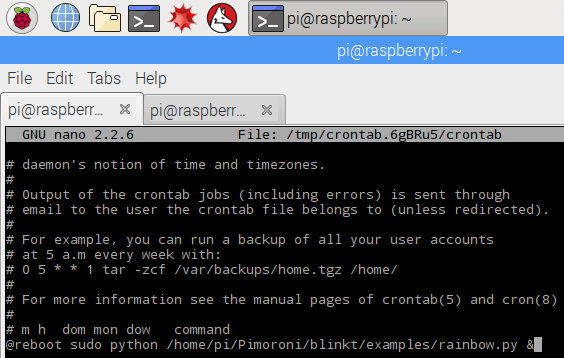

Open a terminal, and type crontab -e. If it's the first time that you've edited your crontab, then it will ask you to choose which editor you'd like to use. I prefer to use nano, and this is the default, so you can just press enter to select it.
At the top of the crontab, you'll see a lot of blurb about how to use it, on lines that are commented out (they begin with #). Scroll all the way down past these lines to the bottom (using the down arrow key) and type, on the last line, the following:
@reboot python /home/pi/Pimoroni/blinkt/examples/rainbow.py &
We're using the full path to the script, all the way from the root. Last, we add & to the end to run the script in the background, so that the Pi will boot as normal.
Once you've added that line, press control-x, y and enter to exit nano.
It should say crontab: installing new crontab assuming you saved the crontab successfully.
Type sudo reboot to reboot your Pi, and the rainbow example should run after a few seconds.
