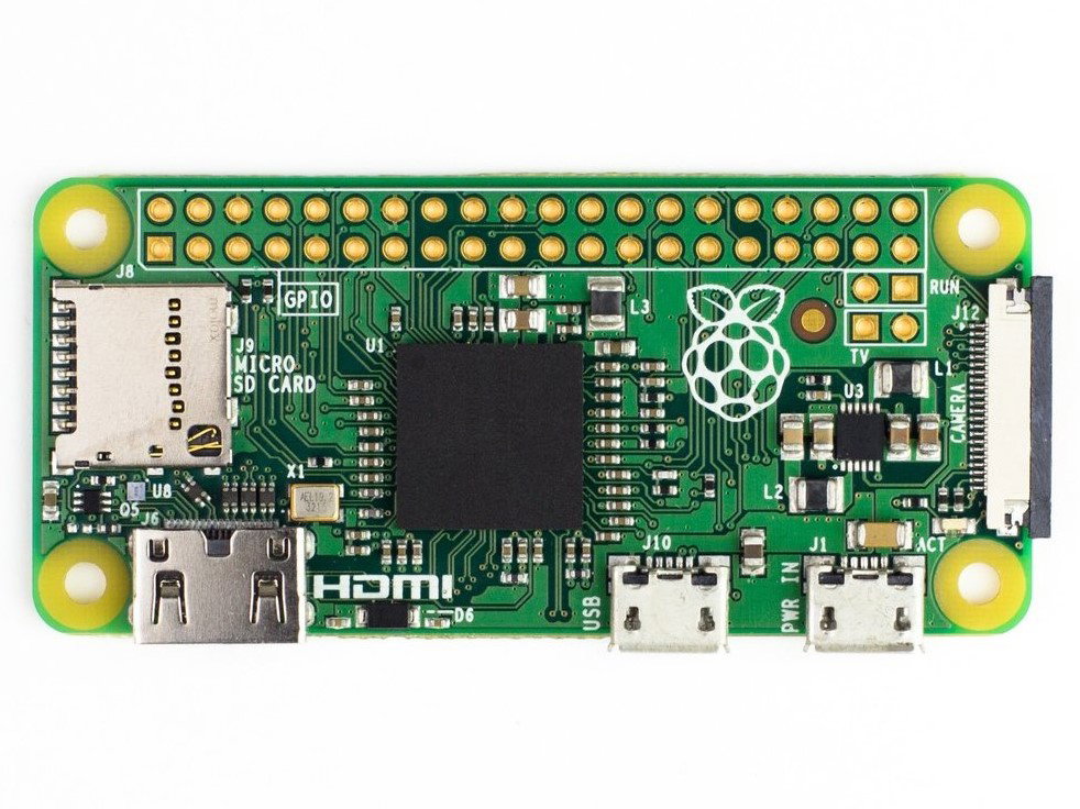

So your Raspberry Pi Zero project is up and running, debugged and ready to roam. The final challenge is finding the best way to power your new creation in the field. In this tutorial we'll explore three ways of powering your Pi.
