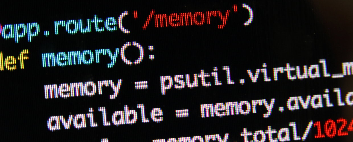

The Code
Glueing Flask and psutil together into a simple system-stats web service is simple.
The following is a barebones example which will serve up CPU percentage at /cpu and available/total memory at /memory.
Download Code
Right-click and download: system-stats.py
import psutil
from flask import Flask
app = Flask(__name__)
# app.debug = True # Uncomment to debug
@app.route('/')
def home():
    return 'System Stats!'
@app.route('/cpu')
def cpu():
    return str(psutil.cpu_percent()) + '%'
@app.route('/memory')
def memory():
    memory = psutil.virtual_memory()
  	# Divide from Bytes -> KB -> MB
    available = round(memory.available/1024.0/1024.0,1)
    total = round(memory.total/1024.0/1024.0,1)
    return str(available) + 'MB free / ' + str(total) + 'MB total ( ' + str(memory.percent) + '% )'
@app.route('/disk')
def disk():
    disk = psutil.disk_usage('/')
  	# Divide from Bytes -> KB -> MB -> GB
    free = round(disk.free/1024.0/1024.0/1024.0,1)
    total = round(disk.total/1024.0/1024.0/1024.0,1)
    return str(free) + 'GB free / ' + str(total) + 'GB total ( ' + str(disk.percent) + '% )'
if __name__ == '__main__':
    app.run(host='0.0.0.0')
Download this code to your Raspberry Pi and run with:
python system-stats.py
