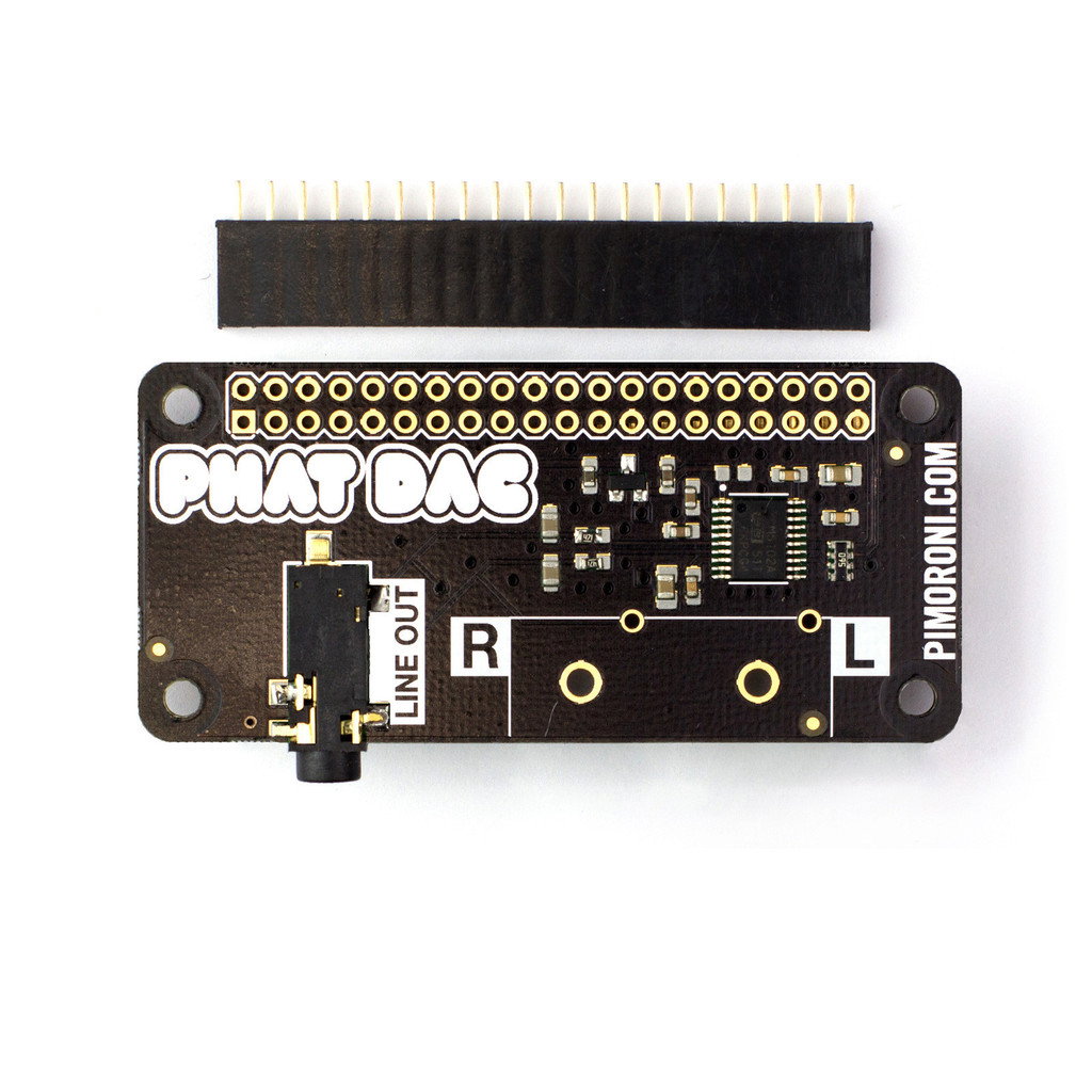

This guide will help you get pHAT DAC up and running on your Raspberry Pi
2 December 2015 · Tutorial · about 15 minutes
This guide will explain how to get pHAT DAC up and running on your Raspberry Pi using the Raspbian operating system.
Before you start, you should make sure that Raspbian is up-to-date, either by following our guide or downloading and installing the latest version.
pHAT DAC provides a line-level output, which means you should connect it to some speakers or a stereo system ready to test your set up. Don't use headphones!
Note that this configuration will disable the default sound modules on your Pi, so that sound will only play through the DAC. We're looking into a better configuration to allow switching between the two, but for now this is the way to go.

pHAT DAC uses the same hardware as HiFi Berry, so we're borrowing their device-tree overlay!
