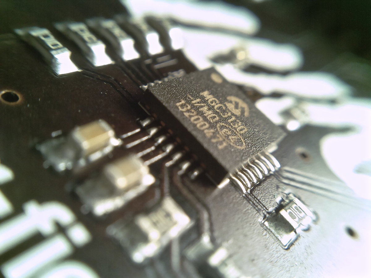

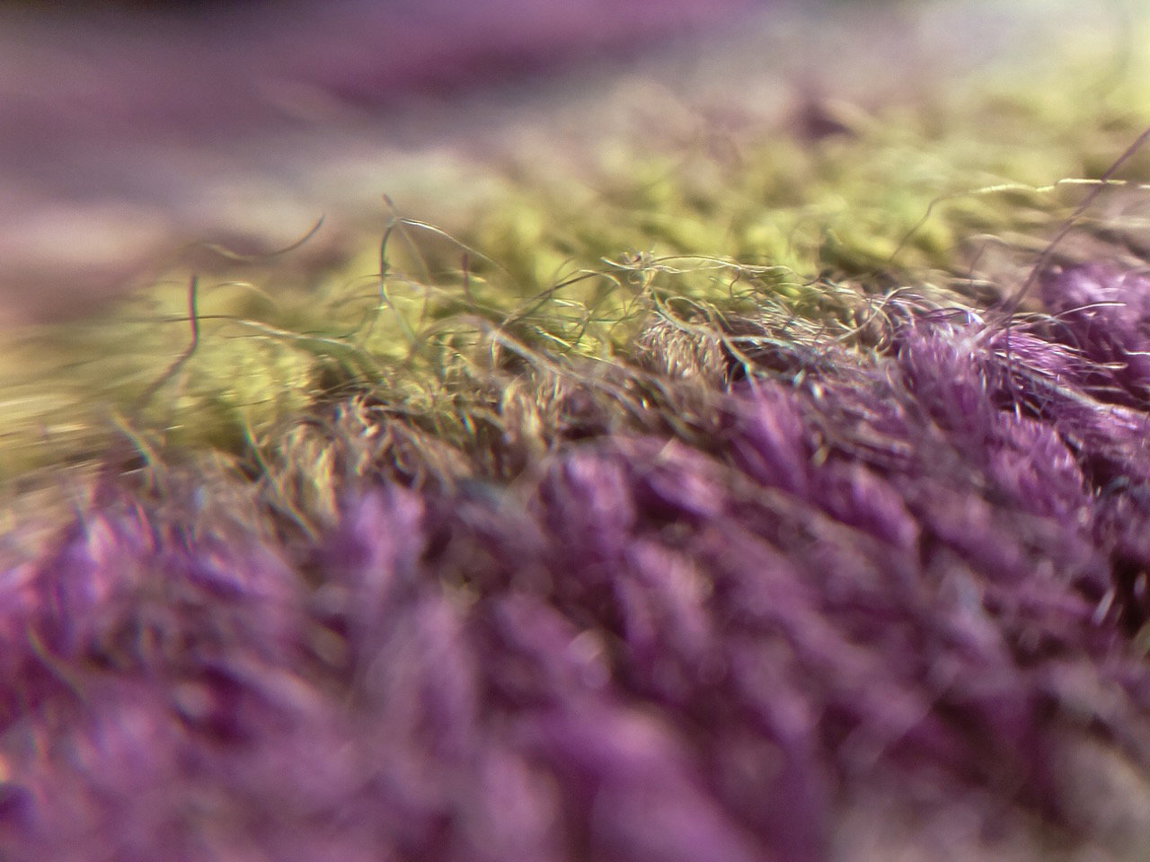

The quality of images from these lenses is remarkably good. Here are some macro images that I took, below, of some wool and one of the Pimoroni HATs. All that's been done to the images below is some sharpening and white balance correction, as the Pi camera sometimes has a bit of a strange colour cast.
Wool macro
Skywriter macro
