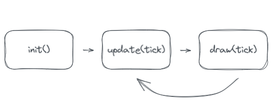

The PicoSystem game loop works by calling three functions declared in your code.
The basic game loop
  • init() is called once when your program starts so that you can perform any setup that's required like generating map data or initialising the player state.
  • update(tick) called every frame to allow you to process user input, trigger sound effects, do collision detection, and update the player state.
  • draw(tick) called every frame and is where you should perform all drawing such as the map, player and enemy sprites, and HUD.
The game loop will run at fifty frames per second (the same refresh rate as the screen) so long as your update() and draw() function don't take too long to complete. Every cycle round the game loop will increment tick by one.
The reason update() and draw() are implemented as separate functions is because it both helps you separate your game processing logic from your drawing code (good practise!) and it allows the game processing code to run in the background while the screen is updating (if you did drawing operations during the screen updates you'd potentially see an effect called "tearing").
