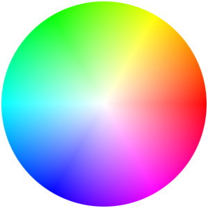

Saturation
I left saturation to last because it requires us to step into 3 dimensions. From the innermost point in our HSV cylinder is mapped the Saturation value. Here the cylinder is completely white, the colours are utterly desaturated. On the outer edge the colours are fully saturated and full of life.
If we viewed it from the very top, it would look like this:
HSV, Top Down

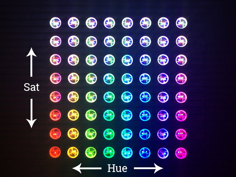

for y in range(8):
    for x in range(8):
        set_pixel_hsv(x,y,(1.0/8)*x,(1.0/8)*y,1.0)
uh.show()

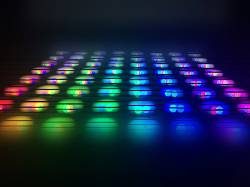

Run this code and your Unicorn HAT will explode with rainbow goodness! It should look something like this:
Unicorn HAT rainbow
Go forth and experiment!
Now go play with range and the values you pass into set_pixel_hsv and see what rainbow patterns you can make!
