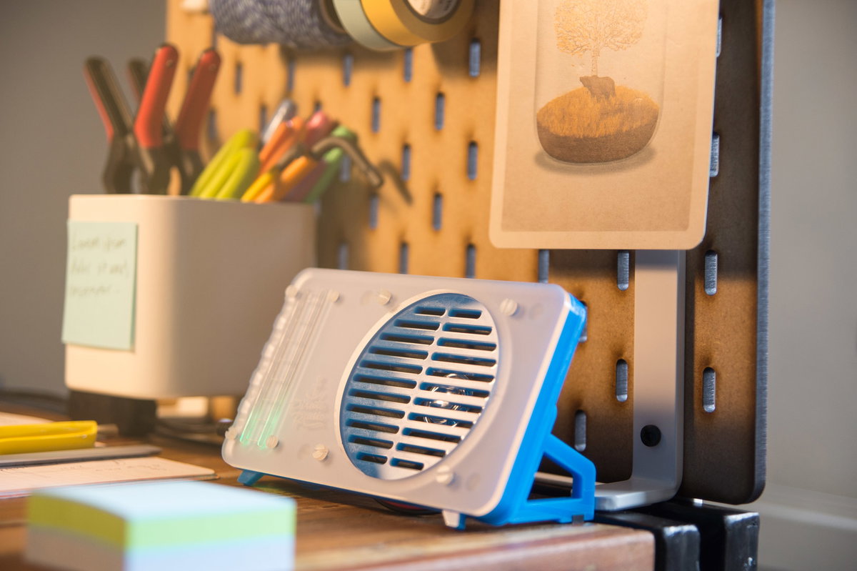

In this guide, we'll be turning your Pirate Radio into a proper internet radio. We've even configured the buttons on the pHAT BEAT to skip between stations, control the volume, and trigger a safe shutdown. The VU meter will display the volume level of your music too!
