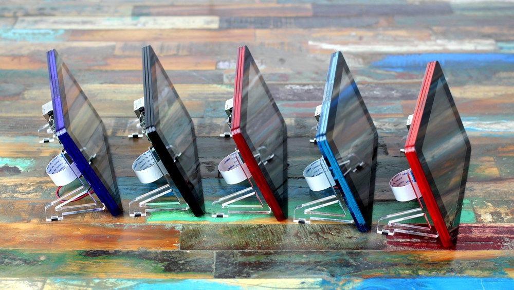

Rotating the screen
If you're using our stand, you'll have to rotate the screen. We've orientated it so that the Pi power, AV and HDMI ports are facing upwards, to keep the sleek low profile look, and the GPIO is at the bottom so you can wrap a ribbon cable underneath for easy access to GPIO via Black HAT Hack3r.

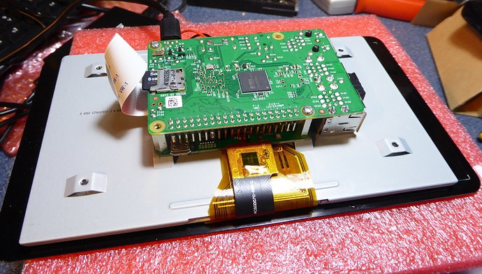

Reverse Mount
As Clive demonstrates below, you can make a much more compact setup by flipping your Pi and mounting it with the ports facing towards the back of the LCD. However, the current GPIO ribbon cables we use won't fit between the two metal risers, so you won't be able to easily break your GPIO out in this configuration.
If you're going for a permanent setup, then you can just solder the power cables to the underside of the GPIO.
Pi LCD guide Image pinched from Clive Beale: https://www.raspberrypi.org/blog/dont-try-this-at-home-how-not-to-hack-the-raspberry-pi-display/
