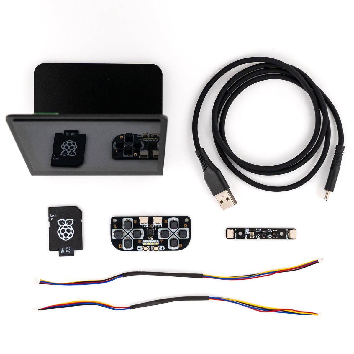

Here's what you get in the Starter Kit:
A top down shot showing the contents of the Starter Kit
Newer starter kits include a long and a short Qw/ST cable, for maximum flexibility.

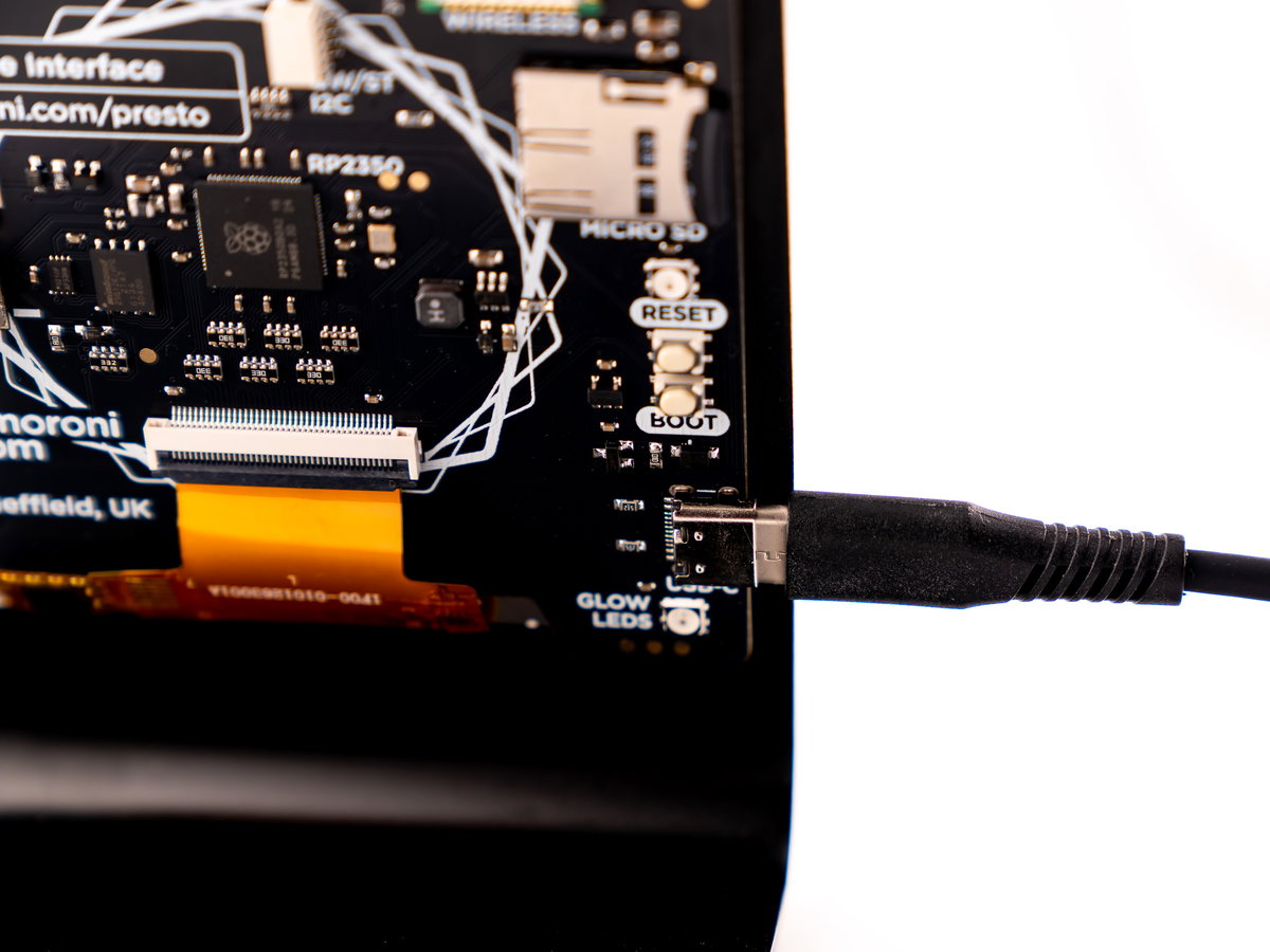

To get started, plug the USB-C end of your USB cable into Presto. This is how we'll provide it with power and also how we'll program the board. The other end goes to your computer, but if you're just checking out the pre-loaded examples and aren't planning on programming the board just yet you could plug it into any convenient USB power source.
Plugging in the USB cable

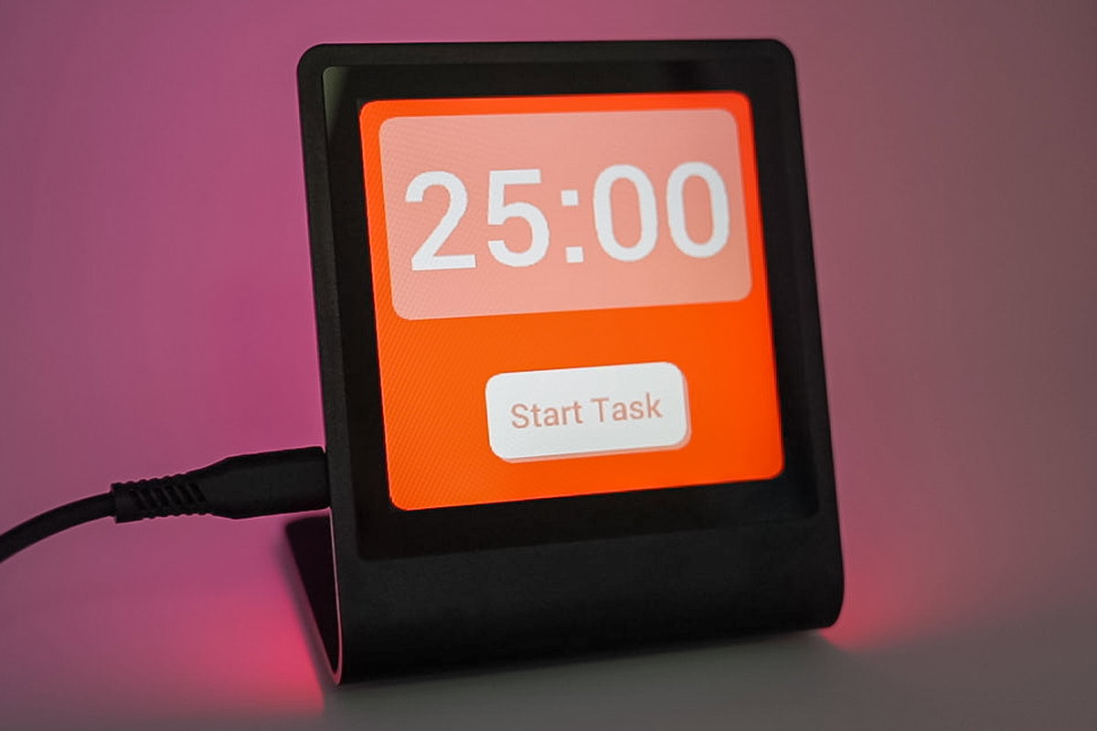

Tomato Timer
The Pomodoro technique is a time management technique that breaks work into short intervals. This example uses Presto's buzzer to alert you after each Pomodoro has finished to tell you it's time to switch focus. You can change the duration of the intervals by editing the code and changing the values under 'Time Constants' - the default is 25 minutes for a task, and 10 and 30 minutes for a short and long break.
Notice how the LEDs on the back of Presto light up in relation to what's on screen? Presto can do this automatically, we'll show you how later on.
Pomodoro example

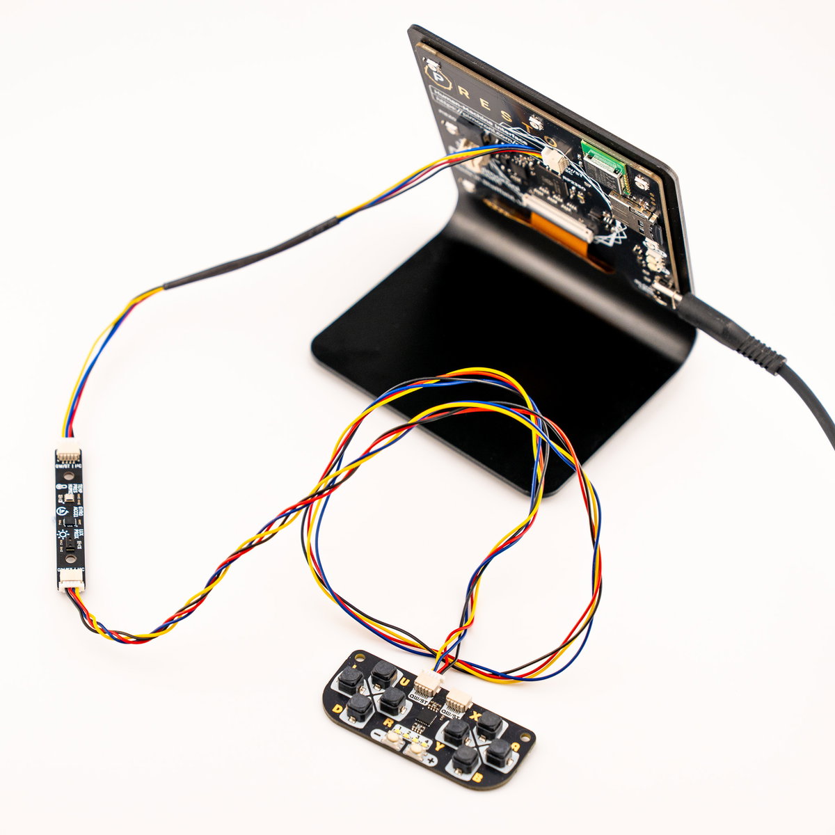

You'll need a Multi-Sensor Stick and a Qw/ST Pad to be able to run these examples. Using a Qw/ST cable, plug them in to the 'Qw/ST I2C' connector on Presto. Hit the reset button once you've done that, to make sure they're detected properly.
Both devices connect via the I2C bus (all aboard!) and have different I2C addresses, so you can have them both connected at the same time if you want. We've added two Qw/ST connectors to each breakout to make it easy to chain 'em with other I2C breakouts.
Plugging in the Qw/ST cable
Presto with breakouts connected

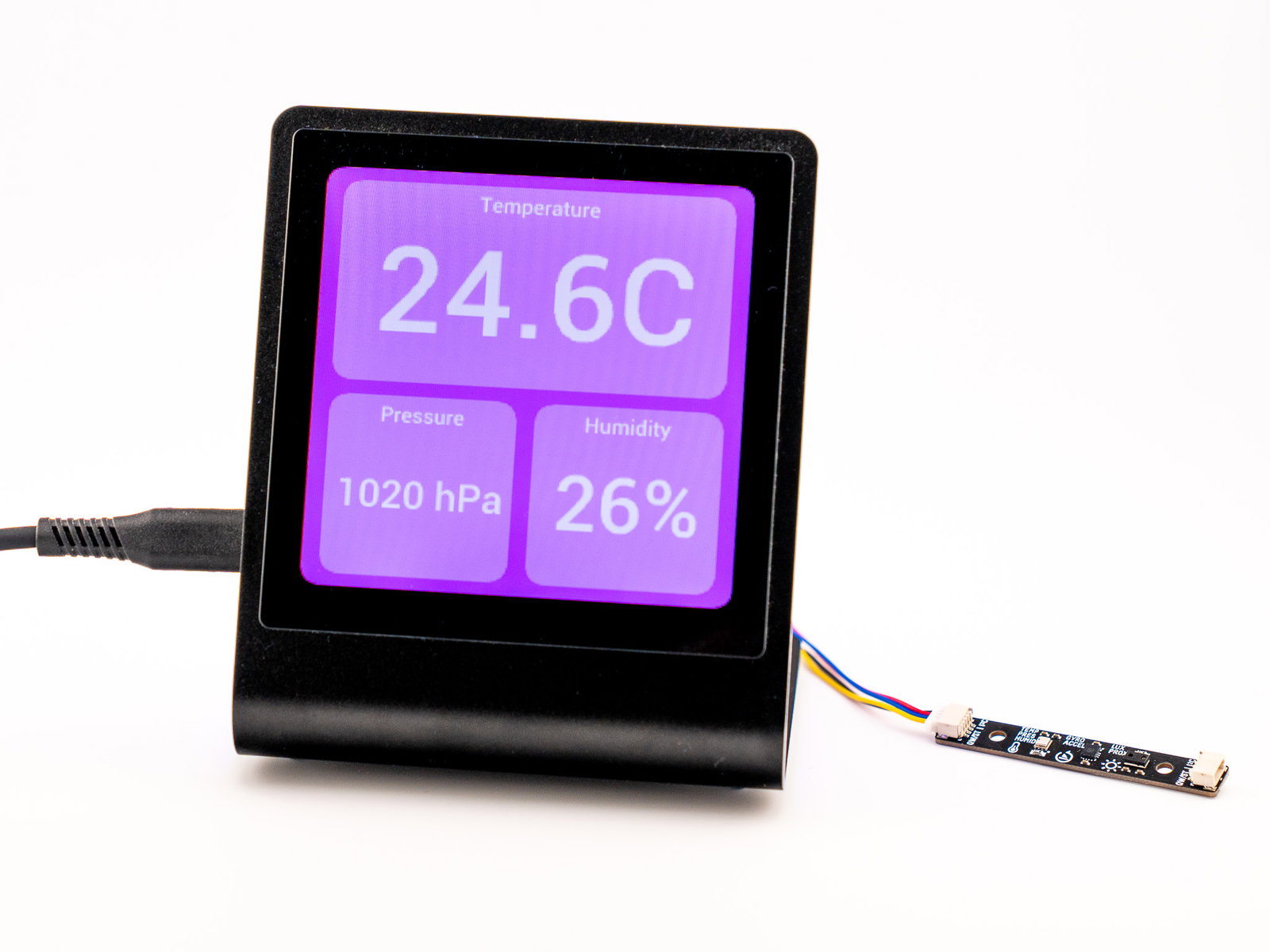

Temperature
This example shows you the temperature, humidity and pressure readings from the BME280 environmental sensor on Multi-Sensor Stick. It uses a handy Widget class for displaying multiple sensor readings.

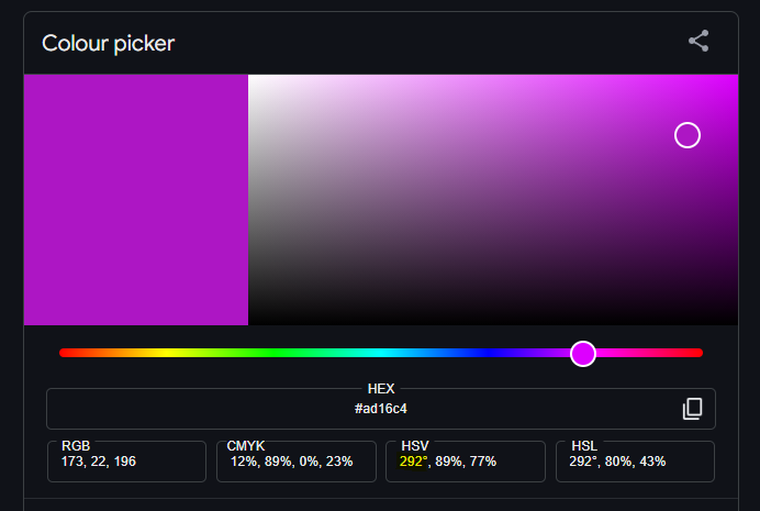

You can change the colours by altering the value of the hue variable. This is a value between 0 and 360°, mapped to a value between 0.0 and 1.0. So find your desired hue on a HSV (Hue, Saturation, Value) colour picker, and then divide it by 360 to provide you with a value between 0.0 and 1.0. This fetching magenta hue was 0.81.
Screenshot of a colour picker, with the Hue value highlighted
Temperature example

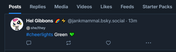

This desk light example connects to Wi-Fi and shows the current CheerLights colour. Tap the bulb to turn the light on and off!
CheerLights is a global network of synchronized lights that can be controlled by anyone. You can change the colour from the Cheerlights Discord server or by including the #cheerlights hashtag in a BlueSky post, like this:
Screenshot of BlueSky

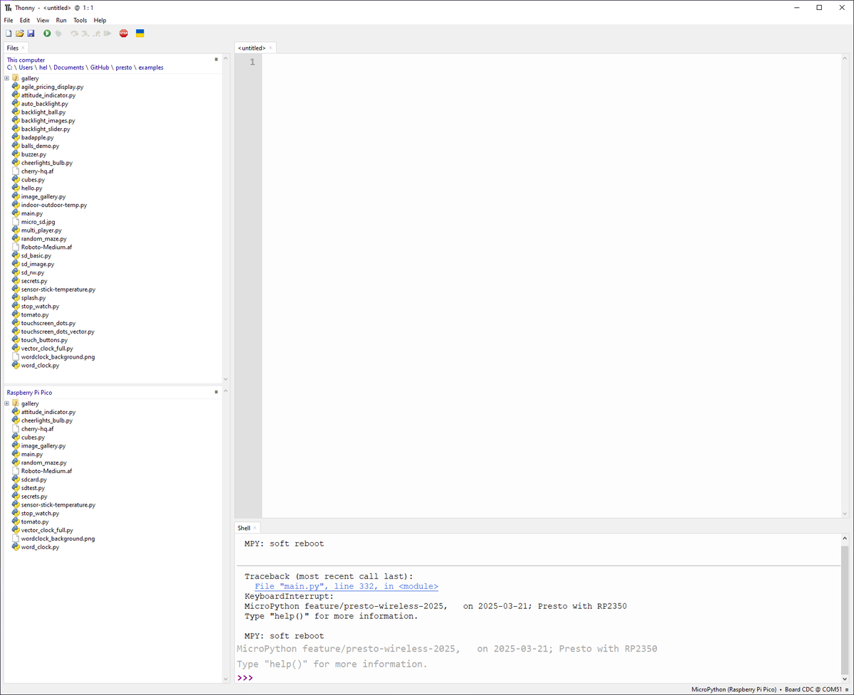

  • Open up Thonny. Make sure the interpreter (shown in the box on the bottom right corner) is set to 'MicroPython (Raspberry Pi Pico)'.
  • Plug Presto into your computer, if it's not plugged in already. Because Presto is busy running the launcher program, main.py will already be running, you may need to interrupt it with the stop button in Thonny before sending it any instructions. In recent versions of Thonny, there's an option to interrupt running programs automatically - if you want to turn that on it's under Tools > Options > Interpreter > Interrupt working program on connect.
  • After you press stop, you should get a MicroPython prompt that looks something like this. The >>> in the 'Shell' box tells you that Presto is talking to your computer and is ready to accept instructions.
Screenshot of Thonny showing a MicroPython prompt
If you're having trouble using Thonny to communicate with your board, there's some troubleshooting suggestions at the link below:
