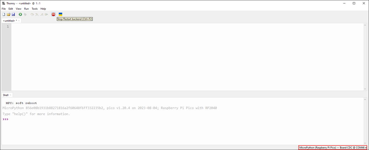

You'll need have 'MicroPython (Raspberry Pi Pico)' selected as your Python interpreter - you can do that by clicking on the box at the bottom right. Thonny might offer to install MicroPython for you, you don't need to do this as you should already have our variant of MicroPython installed.
If you don't see a MicroPython prompt with three arrows like the one above, try clicking the red stop button to interrupt any processes that are running.

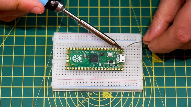

Make sure your workspace has adequate ventilation and consider wearing eye protection as solder can sometimes behave unexpectedly. Once you're ready to start soldering, make sure to tin the end of your iron - wait until it's up to temperature, melt a little bit of solder onto the tip and then clean off the excess using your tip cleaner. You're ready to go!
The first pin being soldered
You'll want to position your soldering iron so it's applying heat evenly to the header pin and the pad on the board, and then hold it in place for a few seconds. You can then feed a little bit of solder into the place where the pad, the iron and the header pin meet - don't go overboard with the solder, you only need a tiny bit and you can always add more later. The solder should flow satisfyingly down the iron and form a joint between the pad and the pin.
We'd suggest soldering one pin at each end, and then checking again to make sure the headers are square. You can adjust them at this point if you need to, but you won't be able to later. Once you're satisfied that everything is 90°, go ahead and solder the rest of the pins.

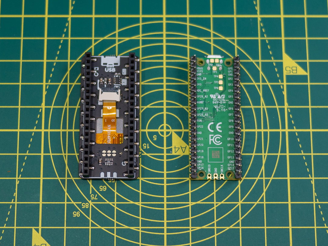

The underside of a Pico and a Display Pack

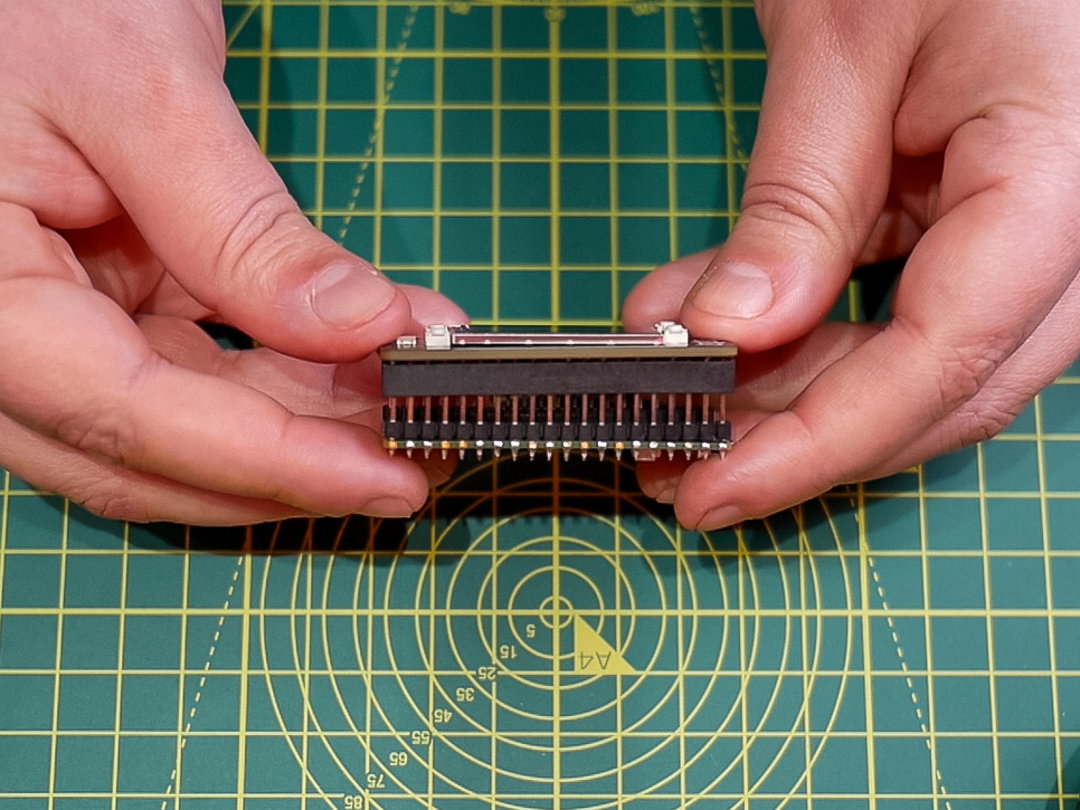

Double check you've got the male and female headers lined up, and push on the edges of the board to join them together (if you're using a Display Pack, take care not to apply pressure to the screen).
Display Pack being attached to Pico
Display Pack and Pico attached together

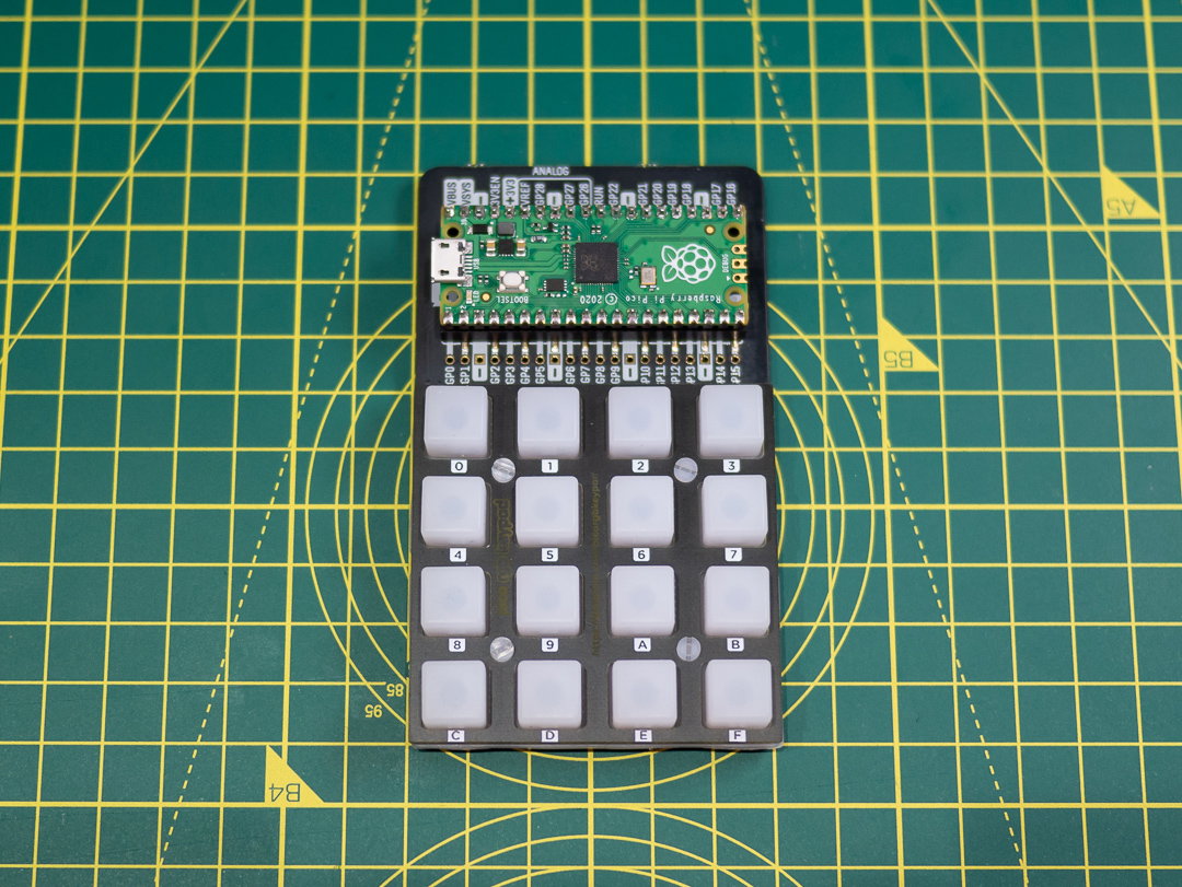

Pico landing areas on Bases are similarly marked, just match up the markings on the PCB to figure out which way round the Pico should go.
RGB Keypad Base with Pico attached
