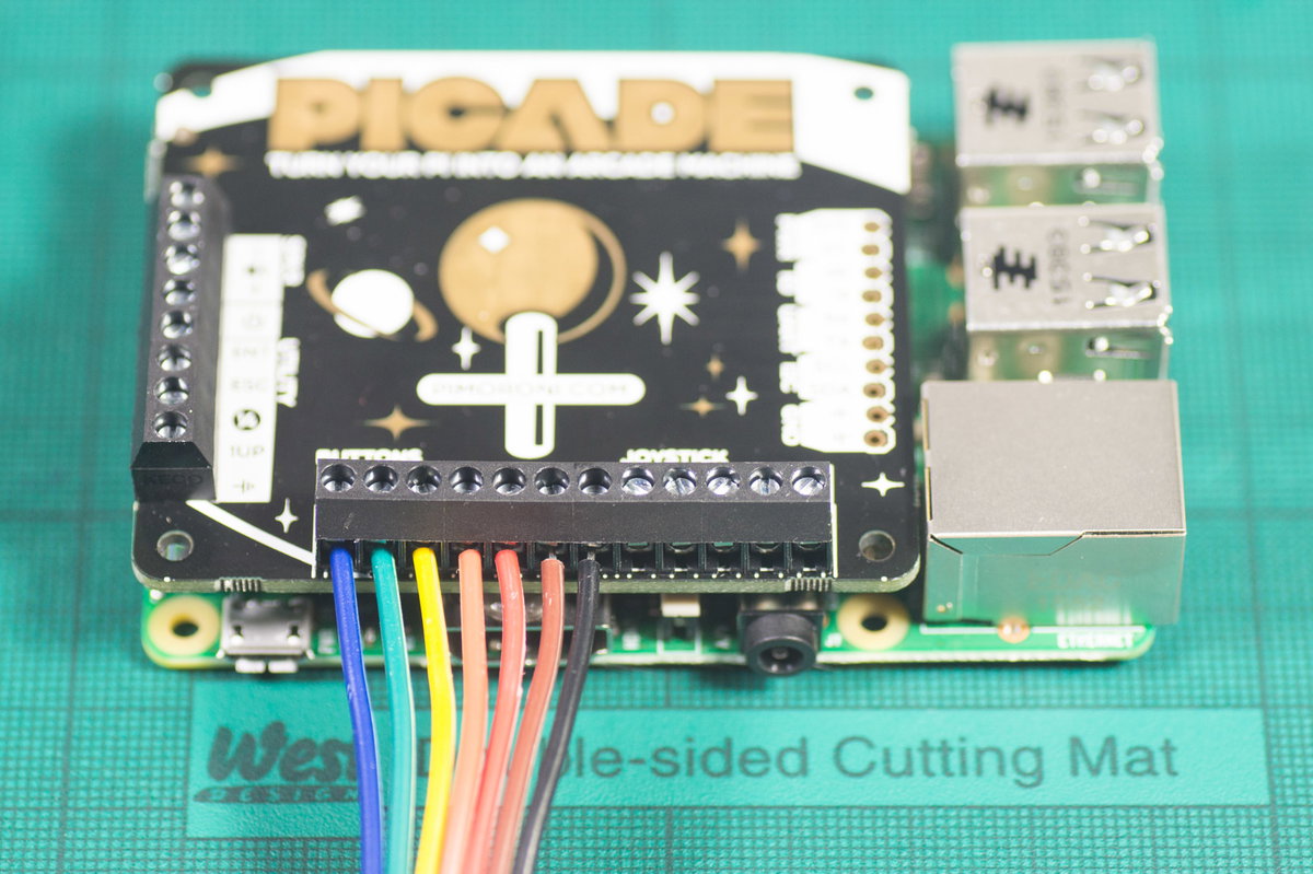

We'll begin by connecting the 6 buttons to the screw terminals on Picade HAT marked 6, 5, 4, 3, 2, 1, ground. Use the wiring loom with the blue, green, yellow, orange, red, brown, and black wires.
You'll see that the black wire has a daisy-chain with 6 spade connectors on; these are the ground wires and they daisy-chain all of the grounds on the 6 buttons back to the single ground terminal on Picade HAT.
Take the bare ends of the wires (the ends without the spade connectors) and separate the wires a little to give you a bit of slack to play with. Push the ends of the wires into the terminal and screw so that the wires are held tight. Begin by attaching the blue wire to terminal 6 and work all the way along until the black ground wire is screwed into the terminal marked with the ground symbol.

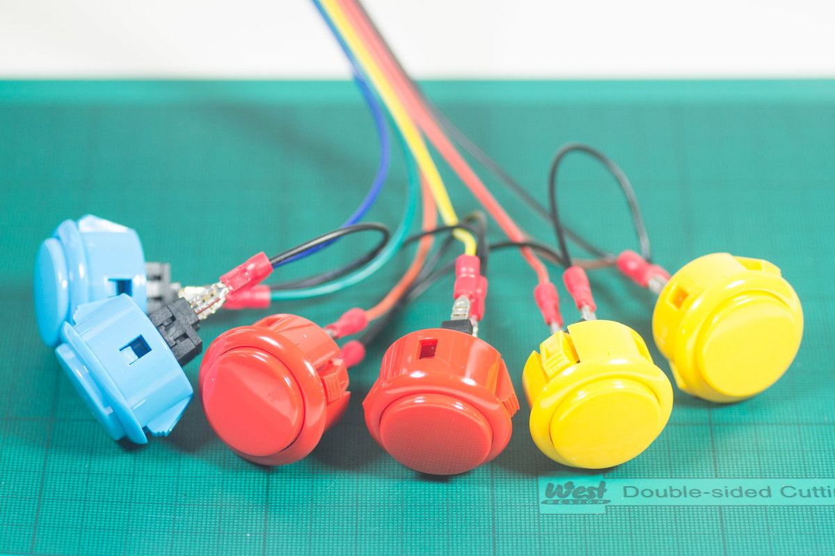

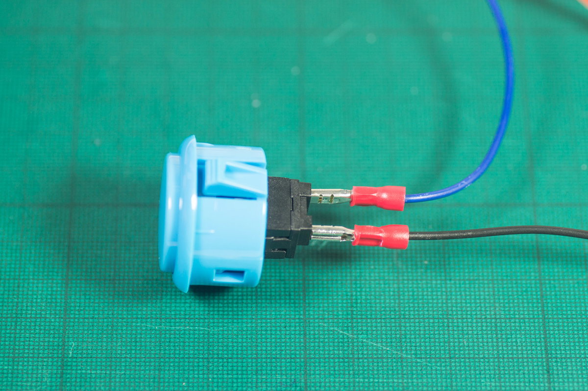

Install your buttons wherever they are going, in your arcade cabinet for example, and then connect each of the spade connectors at the other ends of the coloured wires to one of the coloured buttons. We provide 6 coloured buttons for these "action" buttons and 5 black buttons for the "utility" buttons like start, select, etc.
Next, take the black ground wire and connect one of the spade connectors to each of your 6 buttons.

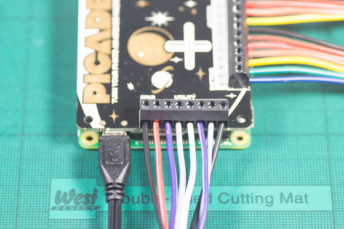

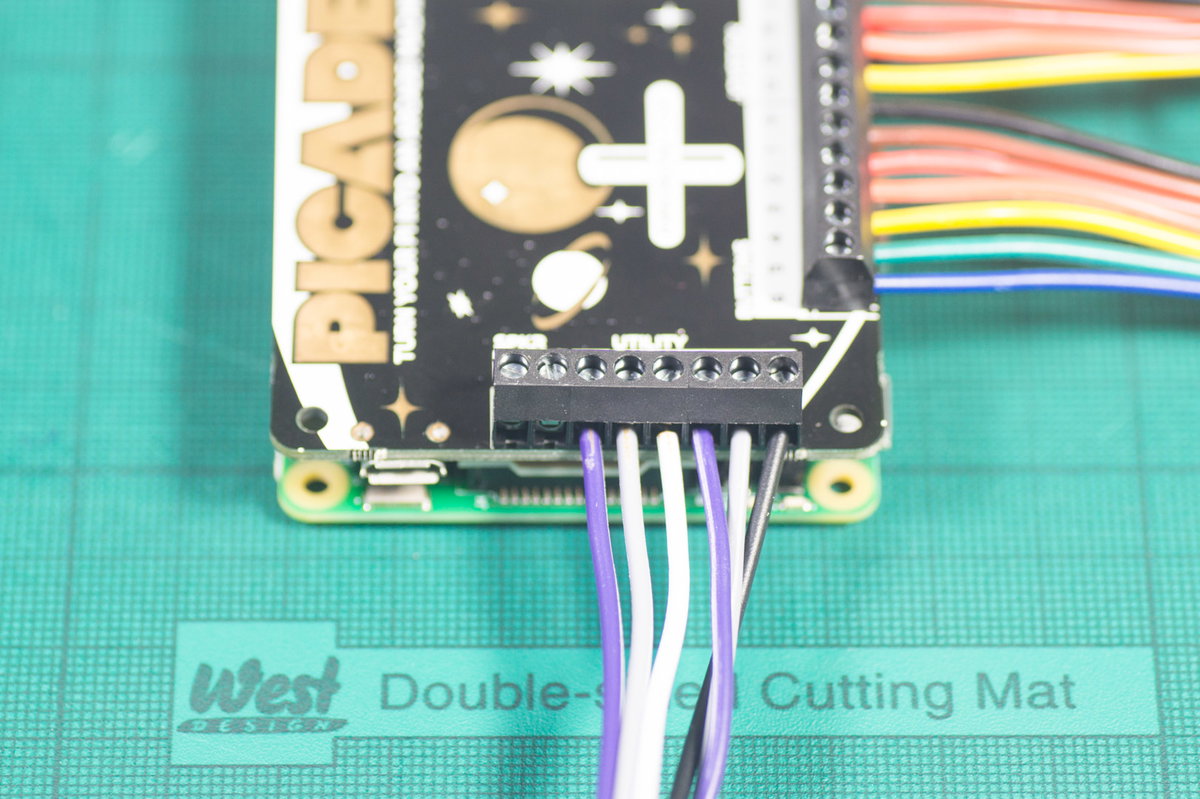

Connecting the "utility" buttons

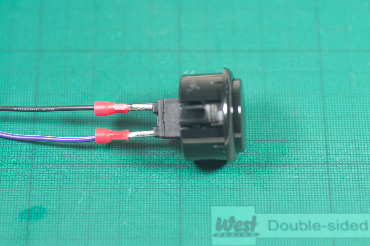

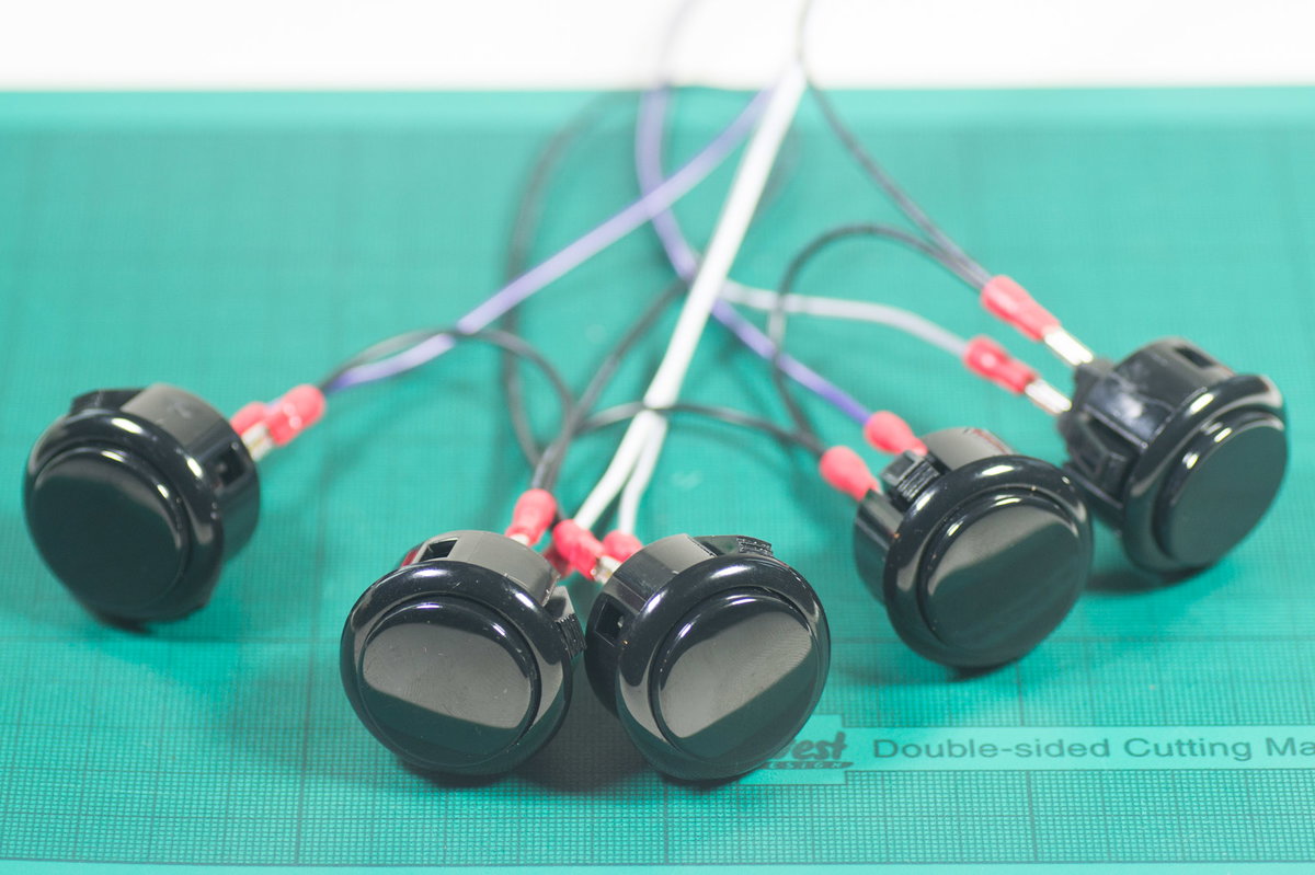

Next, we'll connect the 5 utility buttons. You should have 5 black buttons left for this. Use the two wiring looms with the purple, grey, and white wires, and the black daisy-chained ground wire. Because there are 6 wires provided for these buttons and just 5 terminals, you can strip off one of the coloured wires and snip off the spade connector at the end of the chain, or just wrap the ends with a little bit of insulating tape to prevent any shorts.
Screw the bare ends of the coloured wires into the 5 terminals marked with the power symbol, ENT, ESC, 1/4, and 1UP. Screw the bare end of the black ground wire into the terminal marked with the ground symbol next to these "utility" buttons.
Now, connect the spade connectors on the other ends of the coloured wires to your 5 black buttons, and then connect the grounds up as we did with the 6 "action" buttons.

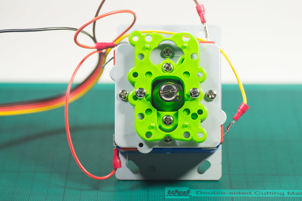

Connecting the joystick
The joystick has 4 switches - one each for up, down, left, and right - and each switch has a positive and a ground spade connector. If you're holding the joystick with the underside facing you, as in the picture below, the up switch is at the bottom right corner, down at the top left corner, right at the top right corner, and left at the bottom left corner.

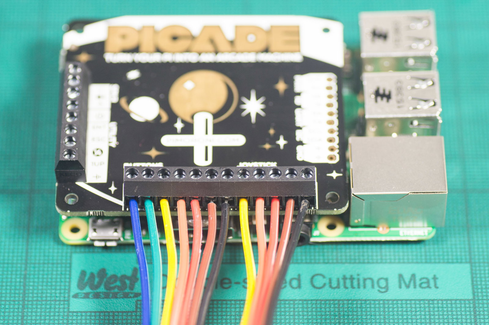

First, as we did for the buttons, we'll attach the bare ends of the wires (the ends without the spade connectors) for the joystick to the screw terminals marked JOYSTICK U, D, R, L, and ground on the Picade PCB.
Use the wiring loom with the yellow, orange, red, brown, and black wires. As with the 6 "action" buttons, the black wire is the common ground and will daisy-chain between the ground terminals on the 4 switches on the joystick.
Take the wiring loom with the yellow wire on the left hand side and the black ground wire on the right hand side and screw each wire into the terminals marked U, D, R, L, and ground respectively.
Next, take the spade terminal wire ends and connect them as follows (assuming you're holding the joystick as described above; it doesn't matter with of the two spade connectors you connect to on each switch):
  • yellow to bottom right
  • orange to top left
  • red to top right
  • brown to bottom left
Then, take the spade connectors of the black ground wire and connect one to each of the remaining terminals.
Connecting the speaker
The speaker comes with a red positive and black ground wire pre-soldered. Screw these securely into the two terminals marked SPKR, the red into + and the black into -.
Connecting the power supply
Plug your microUSB power supply (we recommend a black 2.5A official Raspberry Pi power supply) into the microUSB port on Picade HAT, as shown below.
