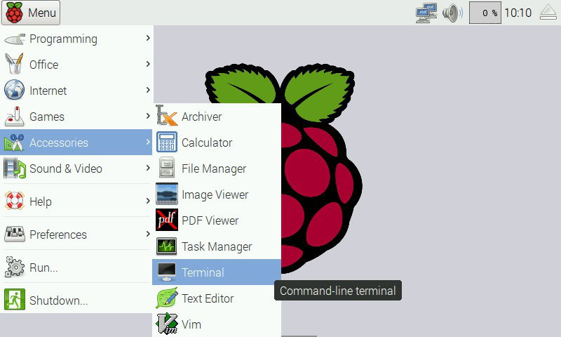

We've created a super-easy installation script that will install all prerequisites and get your Piano HAT up and running in a jiffy. To run it fire up Terminal which you'll find in Menu -> Accessories -> Terminal on your Raspberry Pi desktop like so:
Raspberry Pi terminal
In the new terminal window type the following and follow the instructions:

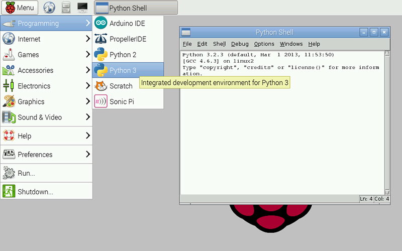

First things first, you need to fire up IDLE, an environment for writing Python scripts. You can find IDLE under the "Programming" category in the Raspberry Pi menu. We'll use "Python 3":
Starting Python 3 IDLE IDE
The window that pops up is called a REPL- Read, Eval, Print, Loop. It's a Python command-line indicated by the ">>>" prompt. You can type in individual lines of Python here and they will be evaluated immediately. It's great for testing ideas in Python and exploring modules.
