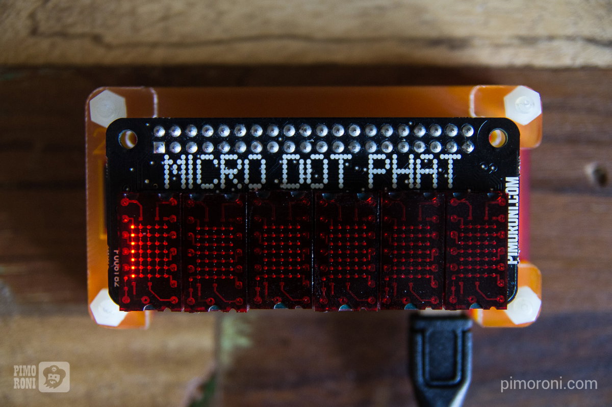

You should now see the top left hand pixel of the first display lit.
Top left pixel lit

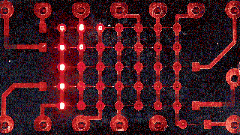

All of the pixels in the first column should now be lit.
First column lit

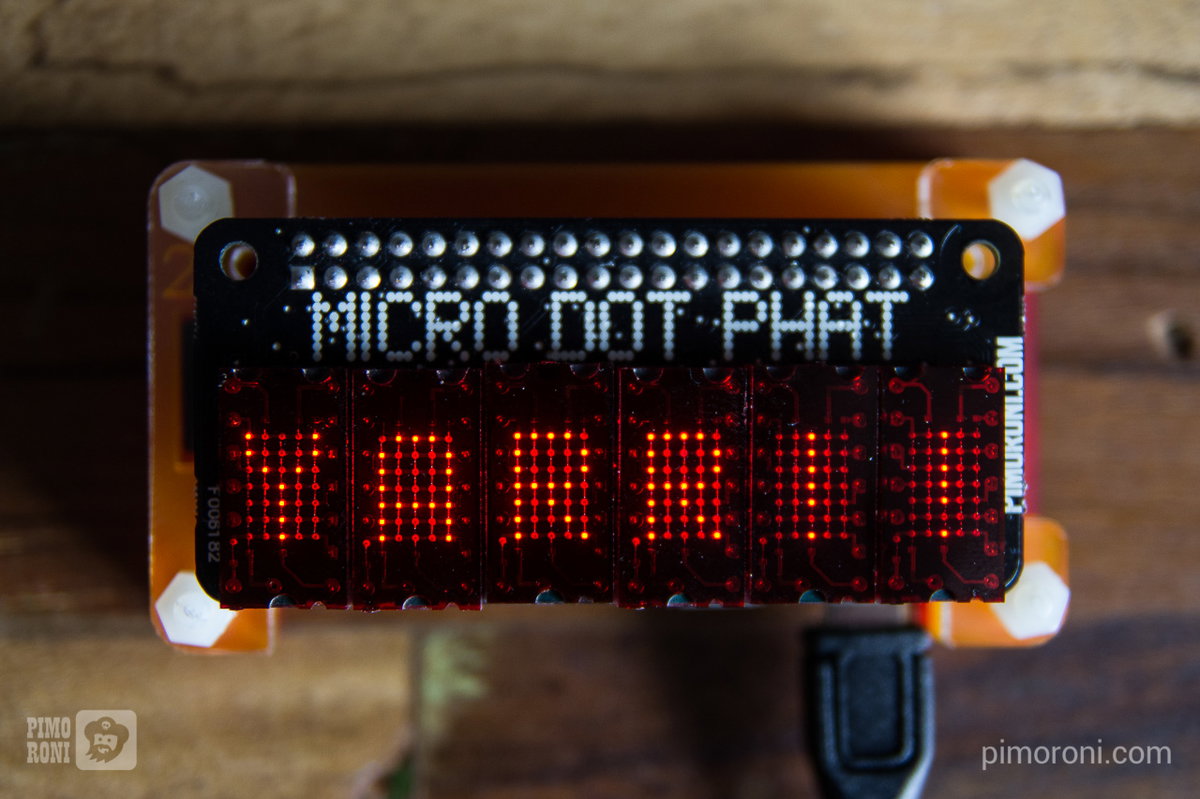

You'll notice that it's awkward to read this text when it's not scrolling. For situations like this, where you have six or fewer characters (assuming you have all six displays installed), we've added an option that you can pass to write_string that specifies how to space the letters, also known as kerning.
Try the following to write one character of our YARR!! string to each of the six displays:
clear()
write_string('YARR!!', kerning=False)
show()
You should now see one character displayed on each matrix.
YARR!!

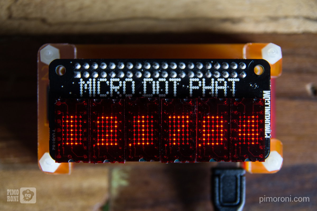

Finally, we'll look at a simple little example of how you can use your Micro Dot pHAT as a retro clock. This example is included with the Python library, but we'll break down what the code does here to help you understand how it all works.
Clock
Here's all of the code:
