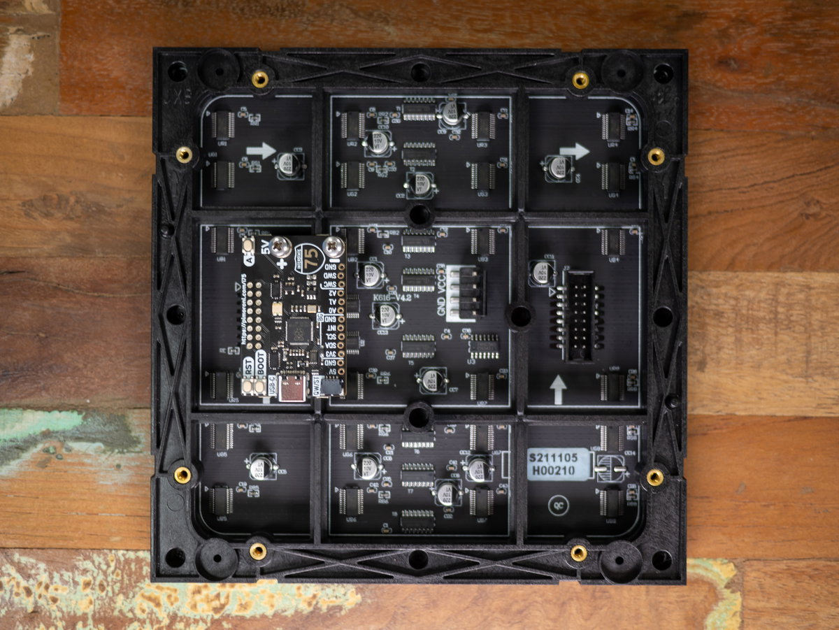

Go ahead and plug the pre-soldered socket header on Interstate 75 into the data in connector on your panel. The data connector has a nubbin on one side of it so you can only plug it in one way.
Panel with Interstate 75 plugged in

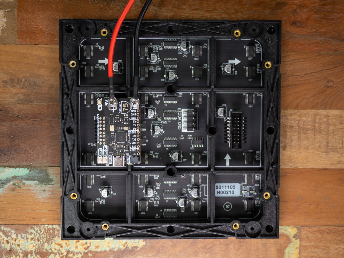

Connecting the power cable
The 16-pin connector on Interstate 75 will only provide a data signal to the panel, it won't provide it with enough electricity to power it. To power the panel, you'll need to connect it up to the screw connectors on Interstate 75, using the red and black power cable that comes with the panel. Loosen up the screws and slot the fork in-between the screw and the metal post, then tighten up the screws and give the wires a little tug to check they're securely held in place. Make sure you have the polarity correct - red to + and black to -.
Connecting the power cables to Interstate 75
The other end of the cable has a white plug on it - plug this to the power connector on your panel (marked 'power' on some panels, or just VCC and GND on others). The clippy part of this connector means it should also only go in one way round, though there's no harm in double checking that the red wires go into VCC and the black wire is connected to GND.
Plugging the power cables into the panel

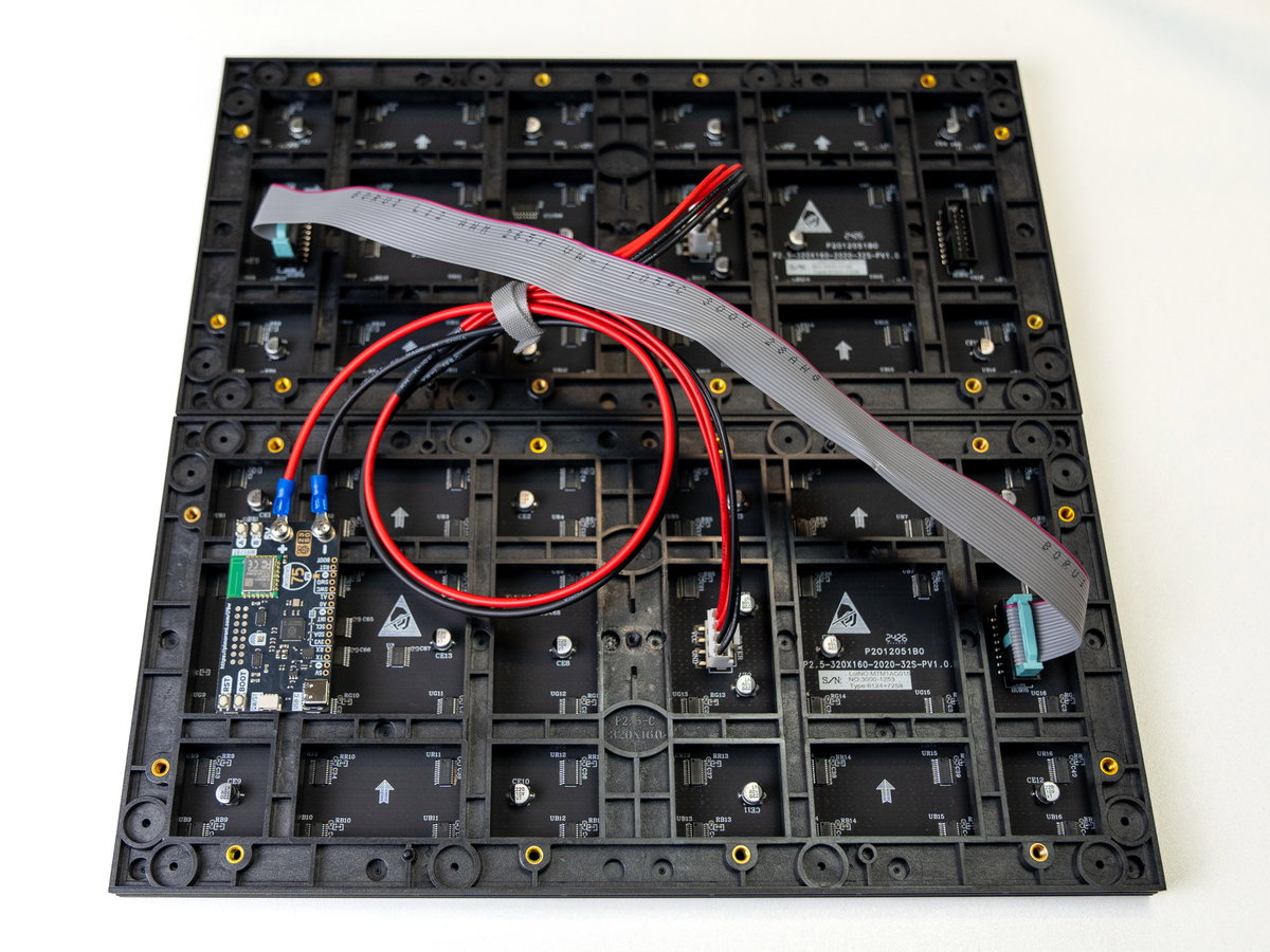

Lay your panels LED-side down with the text on both panels and the arrows pointing in the same direction. We've got our panels arranged in a square, but if you'd rather arrange your in a line with the short edges together that's fine - they'll be wired up in exactly the same way.
Laying down the panels
Plug the pre-soldered socket header on Interstate 75 W into the data in connector on the first panel in your chain. The data connector has a nubbin on one side of it so you can only plug it in one way.
Plugging in Interstate 75 W
Next we're using the grey data cable to connect the panels. One end goes in to the data out connector on the first panel (this is the panel that has Interstate 75 W plugged into it), and the other goes to the data in connector on the second panel.
Adding the data cable
Each panel will need providing with power as well as data, so we need to use the double ended red and black power cable to connect both panels to Interstate 75 W. First we're connecting the power cable up to the panels, using the pair of 4 pin connectors. Clip these onto the corresponding 4 pin power connectors on the panels. They should only go on one way, with the red wires going to VCC, and the black wires going to GND.
Adding the power cable
To connect the power cable to the Interstate board, first use a small cross head screwdriver to remove the two screws from the screw terminals. Then thread the screws through the red and black ring connectors and screw them back into place. Make sure the polarity is correct, with the red wire going to the terminal marked + and the black wire going to the terminal marked -.
Connecting the power cable to Interstate
Here's what the panels look like with both cables in place. We've added a cable tie to tidy up the slack on the power cable.

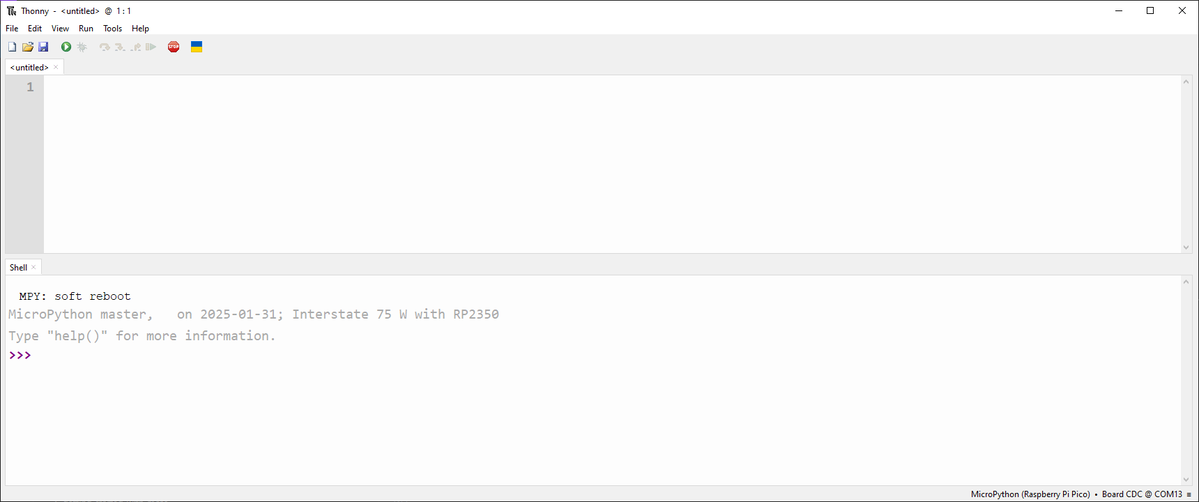

  • Install Thonny
  • Open up Thonny. Make sure the interpreter (shown in the box on the bottom right corner) is set to 'MicroPython (Raspberry Pi Pico)'. If everything's working as it should look something like this. The flashing cursor next to the >>> in the 'Shell' box tells you that Interstate is talking to your computer and is ready to accept instructions!
Screenshot of Thonny
If you're having trouble using Thonny to communicate with your board, there's some troubleshooting suggestions at the link below:
