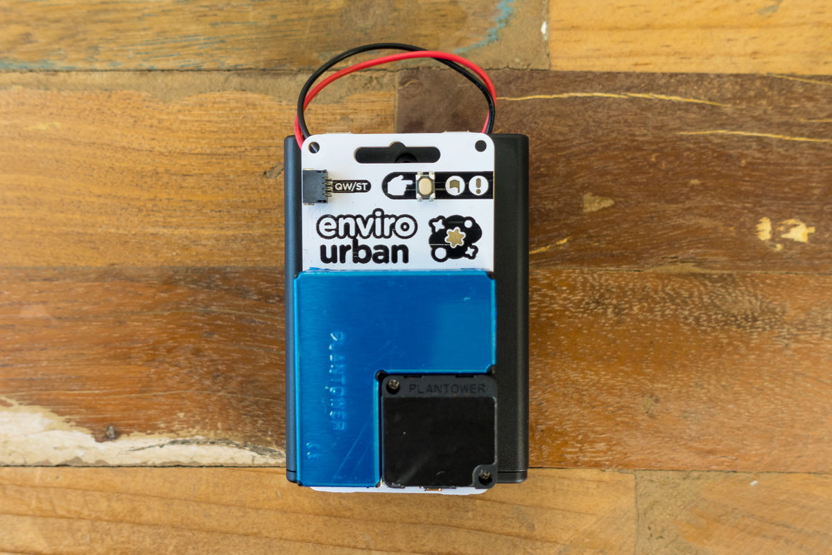

AA or AAA batteries
If you got an Accessory kit with your Enviro, it will come with a suitably sized AA or AAA battery pack and a square of Velcro so you can stick it to the back of Enviro if you want.
Sticking the battery pack to Enviro
Bear in mind that the Pico W's wireless antenna is also on the back, so if you're planning on putting your Enviro somewhere with a weak wireless signal you might not want to position your battery pack directly over the antenna. Also consider that you will need access to the Pico W's BOOTSEL button in the future if you want to update the firmware.
Once you're happy with the placement of your Velcro, press it down and then wait 10 minutes for the adhesive to set. If you have an on/off switch on your battery holder, make sure it's set to 'on'!
Enviro Urban with battery pack attached

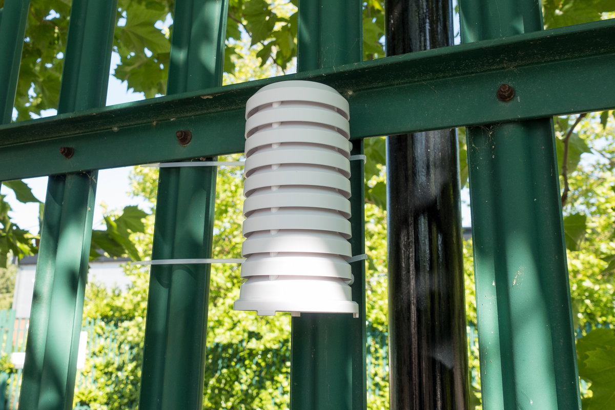

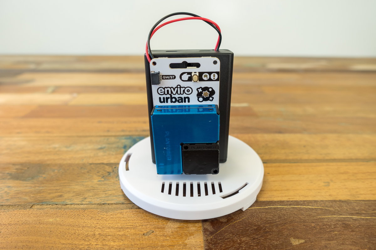

Enviro Urban comes with a weatherproof enclosure, so you can put it outside without it getting damaged by the elements. It has a bunch of slots in the side to ensure that the outside air gets to the sensors. We used the velcro that comes with the enclosure to stick our Enviro Urban and battery combo onto the base of the enclosure.
Attaching Enviro Urban to the base of the enclosure
We then used the cable ties to attach it to the fence outside Pirate Towers, ready for checking up on the particulate emissions of passing shipping.
Enviro Urban enclosure attached to the fence

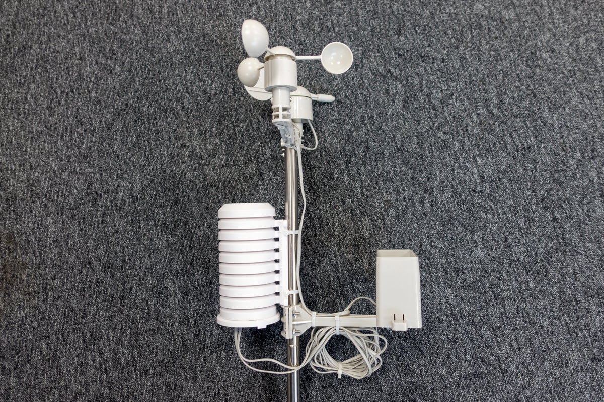

The big white box that comes with Enviro Weather contains the wind and rain sensors, you'll first need to attach them to their pole. The wind sensors mount on the double ended arm that goes on the top of the pole (note that the anemometer has a short cable which plugs into the wind vane, so that both wind sensors can then share the same long cable). The rain sensor is mounted on its own arm that comes out of the side of the pole. If you need step by step instructions (with photos) for assembling the sensors, check out SparkFun's excellent hook-up guide!
Assembled wind and rain sensors
We left some space in between the wind and the rain arms so we could attach our enclosure on the pole as well, but you might want to go for a different formation - just make sure nothing overhangs the rain sensor, as this will stop it from reading correctly.

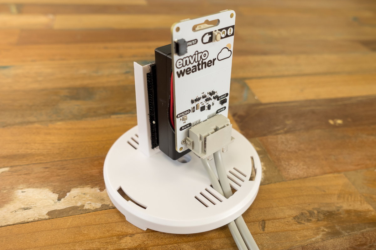

It comes with the same weatherproof enclosure as Urban, but with Weather you'll need to mod it a little to be able to plug in the RJ11 connectors from the wind and rain sensor. We used side cutters to remove a few struts from one of the grills one the base of the enclosure to give us room to poke the connectors through, but you could enlarge the existing cable hole with a dremel or a drill if you prefer (mind your fingers).
Making a hole in the base of the enclosure
Plug the wires from the wind and rain sensors into the labelled connectors on Enviro Weather. You can tell which sensors the wires come from by peering at the connectors - the RJ11 connector that comes from the wind sensors will have four wires inside it (two for each sensor!) while the rain sensor connector only has two. The wind cable is a bit thicker than the rain cable, because of the extra wires.

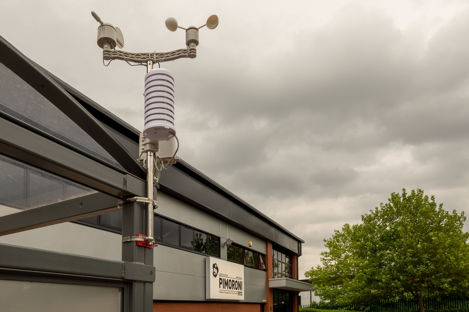

We then used Jubilee clips to attach the pole to a structure in front of Pimoroni HQ. When you install the wind/rain sensors in their final location, make sure you align the markings on the wind vane to North and that the rain gauge is level.
Assembled Enviro Weather and sensors in front of Pimoroni HQ

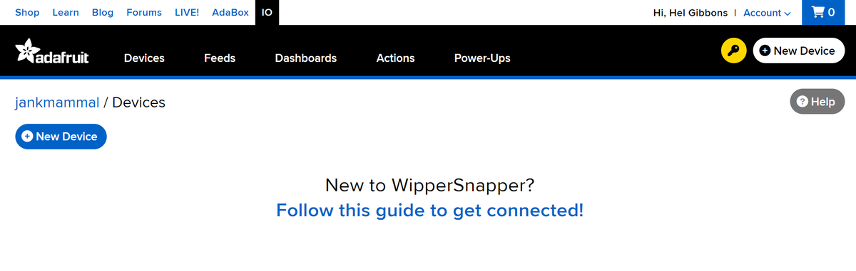

In this tutorial, we'll be posting our data into adafruit.io, an easy to use cloud data service. If you want to do the same, we'd suggest signing up for an adafruit.io account before you start setting up your Enviro. You'll need two things during setup: your username and your Adafruit.io key. You can find both of these by clicking on the yellow key at the top right of the adafruit.io site when you're logged in.
Finding your adafruit.io username and key
The key is a long number, so we'd recommend copying it to the clipboard of your device now, so you don't have to write it down/type it in later.

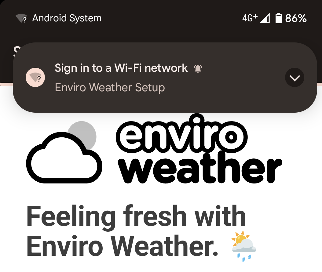

Make sure Enviro has battery or USB power. If it's not been through the provisioning process already, it should automatically go in to provisioning mode and the white ACTIVITY LED will start flashing rapidly (if it's not doing that, try pressing RESET on the back of the board).

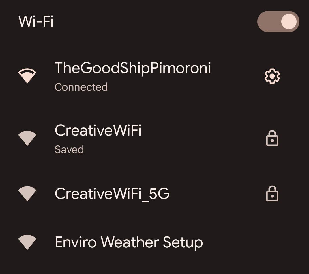

On your phone (or other wireless device) go into your internet/wireless settings, and find and connect to the wireless network called "Enviro Setup". Here's what that looks like on an Android phone:
Connecting to the Enviro Setup network
For us, a browser window opened automatically once our phone was connected to the Enviro network, but on some devices you might need to click on a message that says 'sign in to network' or similar to get it to pop up (you won't actually have to sign into anything).
Screenshot showing being connected to the captive portal
⚠ If you've having trouble with your phone or tablet staying connected to the Enviro network, try turning off your mobile internet connection temporarily - your device might be searching for an internet connection and automatically switching to mobile internet.
Once you're connected, the web pages (which are all being served from the Pico W itself) will walk you through how to set up your Enviro. There's more info about what each step does in the quickstart guide.

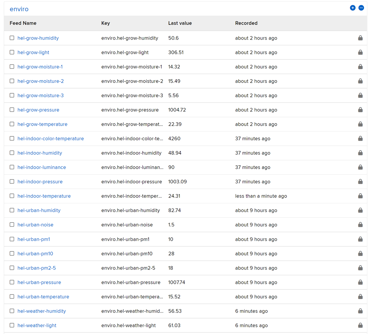

Viewing your data in adafruit.io
To start seeing your readings in Adafruit IO, you'll need to go onto the Adafruit.io website and, on the 'Feeds' tab, create a new group called 'enviro'. Once you've done that, readings should start showing up on this page when your board next posts them. Simples!
A list of feeds
(note that we've got a lot of feeds going on here - if you have a free account you won't be able to create this many).

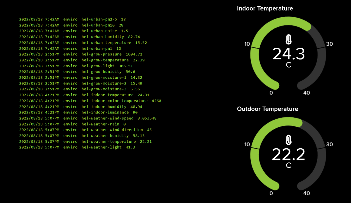

Line charts showing weather data
Once you select a type of block you'll get asked what feed/s to associate it with. You can move blocks around and resize them with 'edit layout'.
We've also used some gauges here to keep track of external and internal air temperature at Pirate Towers, and a stream block with all our feeds added to it to see exactly what's been posted in:
Temperature gauges and a stream block
Adafruit IO's free tier lets you store data for 30 days and lets you post up to 30 data points a minute. This sounds like a lot, but bear in mind Enviro returns 7 or 8 different sensor readings at a time and it bundles multiple sets of readings together (so you might be submitting readings for a couple of hours, but they're all being posted in the same minute). If you exceed this limit you may see throttling errors start showing up in Enviro's log.

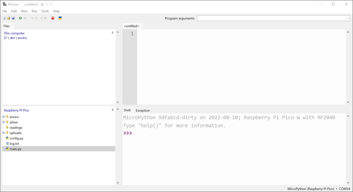

Connecting to Enviro with Thonny
But what if something isn't working and you have a red light, a static white light or no readings showing up? Here are some things that might help.
Enviro logs everything it does in a file, so you can plug it into your computer to view any errors. To view the files (and program it in MicroPython) you'll need to talk to it through an interpreter - we're using Thonny, which is available for Windows, Mac or Linux. Here's how to get Enviro and your computer talking to each other.
  • Install the latest version of Thonny. We'd suggest downloading it from the Thonny website, as package managers don't always have the most up to date versions.
  • Plug Enviro into your computer, if it's not plugged in already.
  • Open up Thonny. Make sure the interpreter (shown in the box on the bottom right corner) is set to 'MicroPython (Raspberry Pi Pico)'.
  • The MicroPython prompt and >>> in the 'Shell' box tells you that Enviro is talking to your computer and is ready to accept instructions. If you don't see the MicroPython prompt in the shell box, try pressing the red stop button in Thonny to interrupt whatever it's doing.
  • You'll want the Files window visible so you can see the files on Enviro. If you can't see it you can open it up with 'View > Files'.
Screenshot of Thonny
The files in the top box are the ones on your computer, and the ones in the bottom box are the ones on Enviro.
