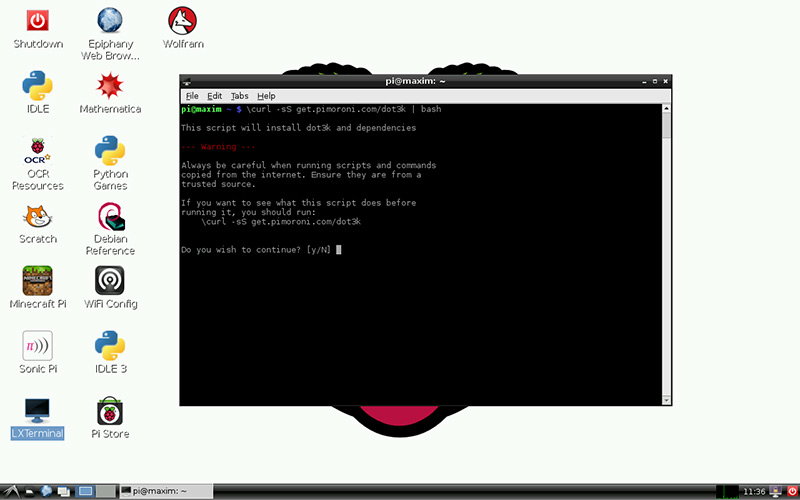

With Step 2 above in mind, and making absolutely sure you've got an internet connection on your Pi, fire up the Terminal and enter the following command:
curl https://get.pimoroni.com/displayotron | bash
Display-o-Tron install start
This install script will guide you through the setup process for Display-o-Tron 3000. As part of this process it will ask if you want to set up SPI and I2c, make sure you answer yes.
