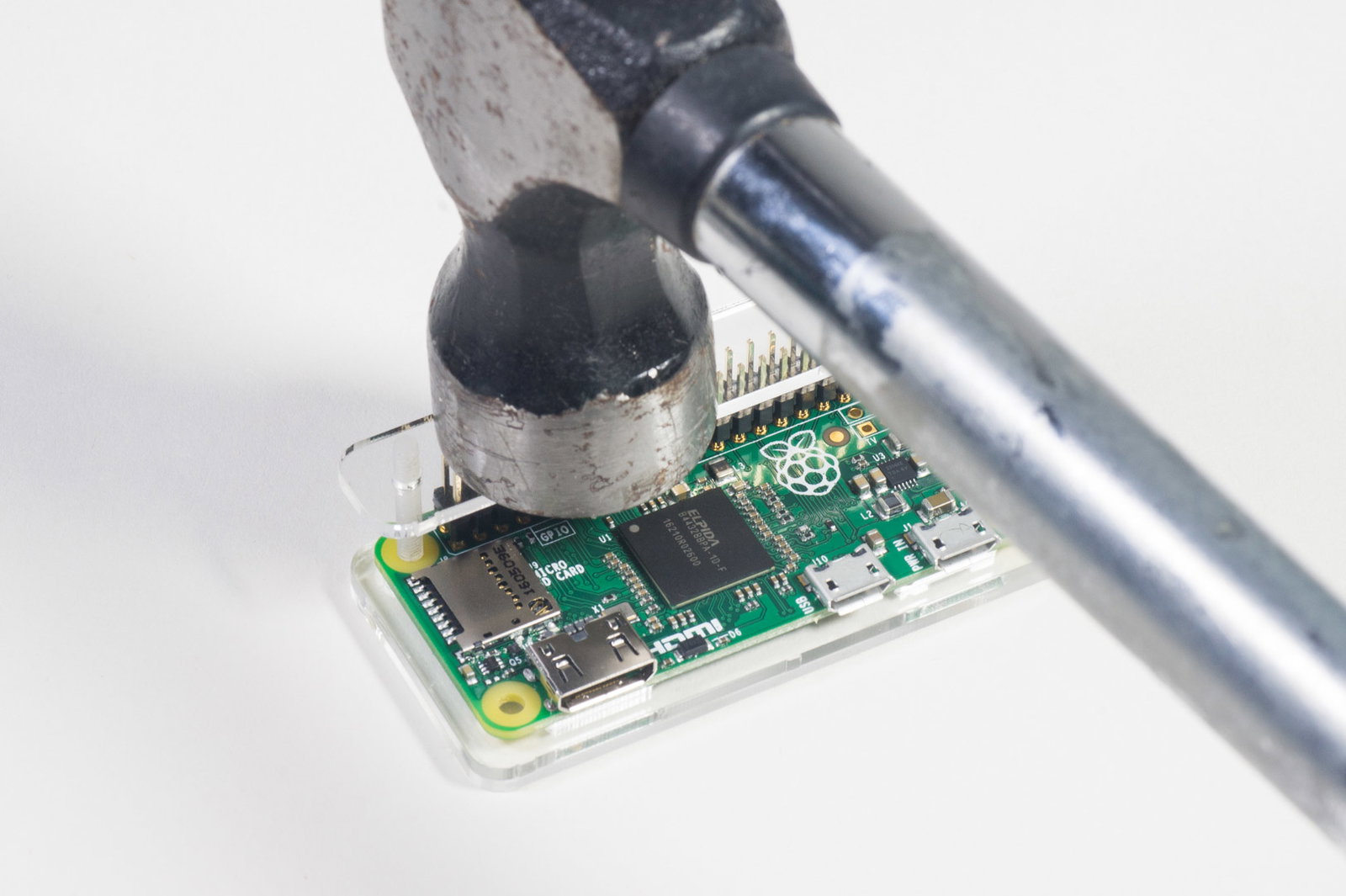

Place the hammer header on top of the pin holes on your Pi Zero, making sure that the longer ends of the pins (without the retaining nubbins) are pointing upwards.
Now, place the last acrylic piece on top of the pins and push it down until it touches them.
Using a hammer, gently tap back and forth on the top acrylic piece to push the pins through. Pushing one end of the header all the way it can cause the other pins to bend when you hammer them in. It's worth taking your time over this part.

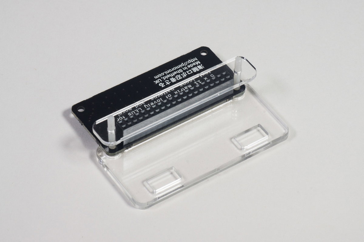

Female headers (for pHATs)
If you're fitting a female header to a pHAT, simply turn the pHAT over and rotate it through 180 degrees, as in the diagram below.
Again, if you have a kit with metal nuts and bolts, then screw the nuts onto the bolts now, to hold the PCB securely to the baseplate.
It should be much easier to fit the female header, and you can use a little more force as you're hammering onto the plastic of the header.
