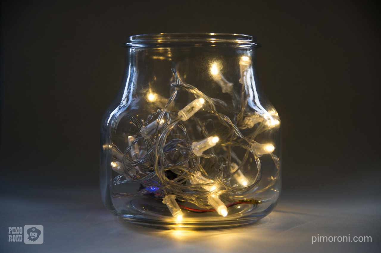

Here we'll be making a pretty little firefly light in a jar, with two strings of LED lights that pulse on and off gently. The whole thing is wireless, so it makes a lovely decorative light to sit on a shelf during a party, or out on your patio on a (dry) summer evening.
Firefly light

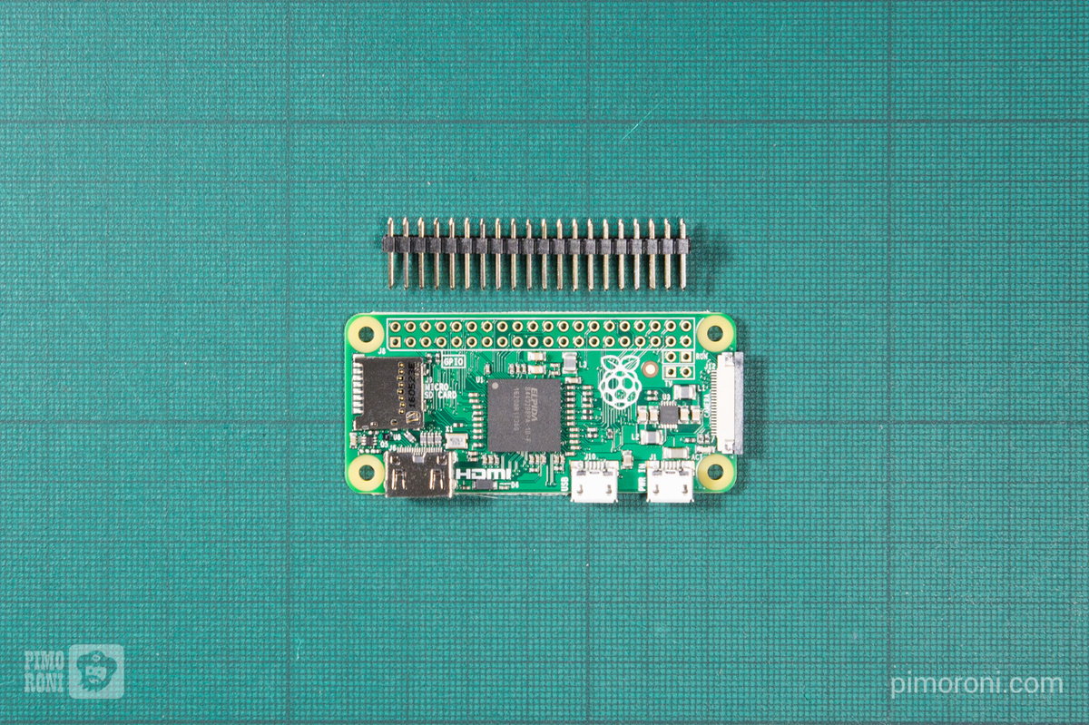

The first thing we'll do is to solder the 40 pin male header onto your Pi Zero. The Explorer pHAT with LiPo SHIM attached with its female header will plug onto the Pi Zero's male header later.
Pi Zero and header
Stick the shorter ends of the header pins through the holes on the Pi Zero, from the top side (the side with the micro SD slot and micro USB ports on top), and then use a piece of Blu-Tack to hold it in place and help hold it steady on your desk.
Flip the whole thing over, so that you're now looking at the underside of the Pi Zero. We've got a guide on how to solder Pi Zero pHATs here, so if you're unsure of how to solder then check that out for some tips. Solder each of the 40 pins, beginning with one of the corners and making sure that the header is straight before proceeding. If it's squint after soldering this first pin, then use your soldering iron to carefully re-melt the joint and straighten the header. You're aiming for a nice dome of solder that covers the whole of the copper ring surrounding the hole.

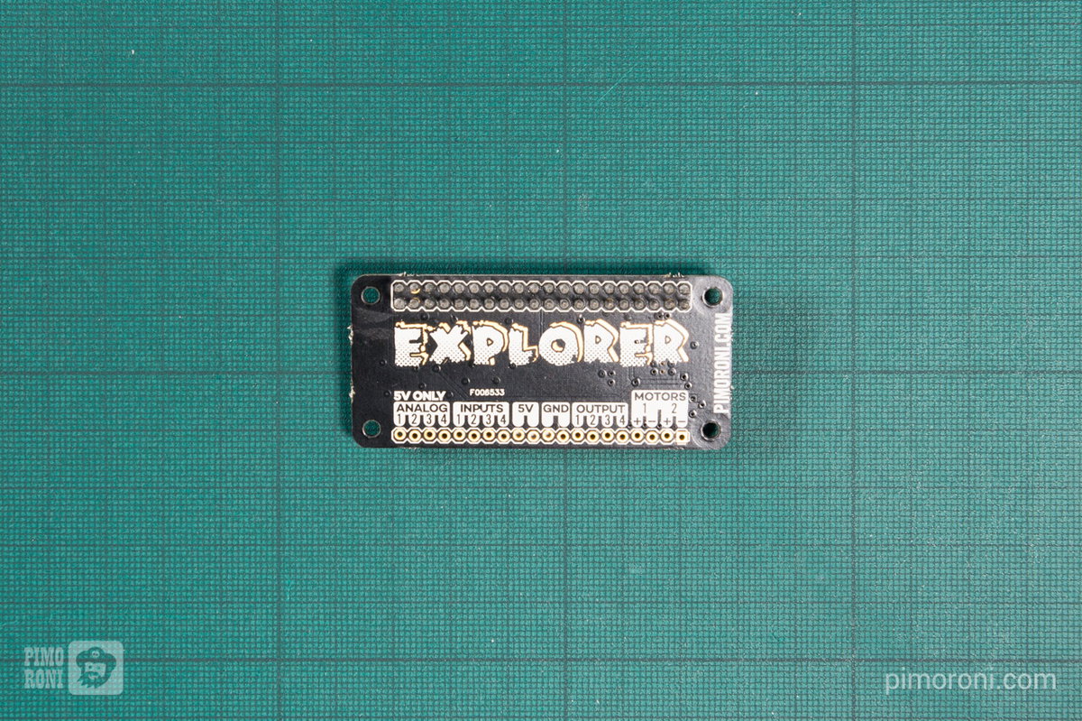

We're using an extra long female header for the Explorer pHAT because it will give us enough extra pin protruding to solder the LiPo SHIM on top.
The female header will be going underneath the Explorer pHAT, so stick the pins on the header through from the bottom side of the board (the side without the big Explorer logo), so that they protrude through the top of the board. Again, a piece of Blu-Tack can help to hold the header in place on the underside of the Explorer pHAT.
Solder all 40 pins, just the same as you did for the male header on the Pi Zero, ensuring that the whole of the copper ring around the hole is covered with solder.
Explorer pHAT soldered
Note: don't solder the single row of header to the pins on the bottom edge of Explorer pHAT, as we'll be soldering our LED lights straight into these holes.

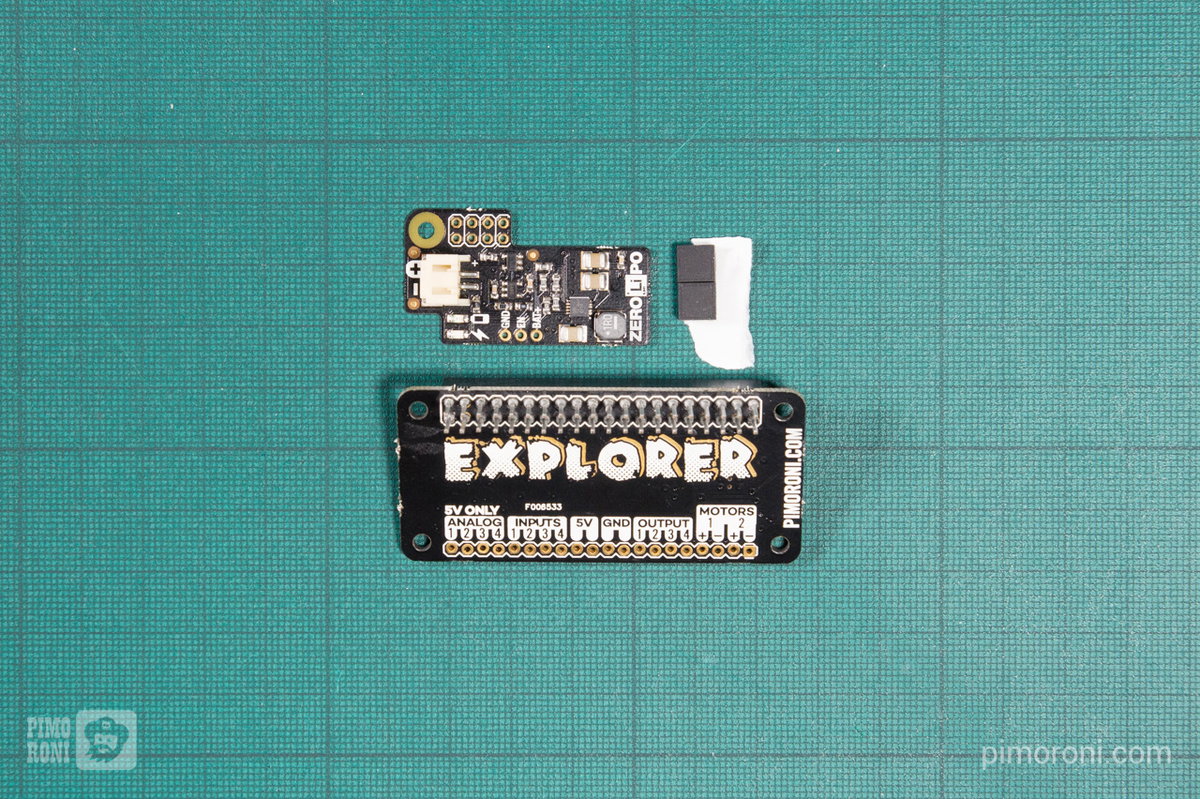

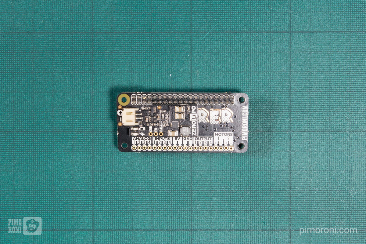

Soldering the LiPo SHIM onto your Explorer pHAT
We're going to solder the LiPo SHIM on top of the extra pins protruding through the top of the Explorer pHAT that we just soldered. It's important to note that the LiPo SHIM should be soldered onto the first 8 pins of the header. These will be the leftmost 8 pins if you're holding the Explorer pHAT so that you can read the Explorer text on top of the board.
LiPo SHIM
Use the little rubber foot to space the LiPo SHIM a little way of the Explorer pHAT board. Stick it on the underside of the LiPo SHIM, and then slip the board down over the leftmost 8 pins, with the white JST connector (for the battery) facing upwards.
Solder the 8 pins of the LiPo SHIM, again ensuring that you have sufficient coverage of the pins.
ZLiPo SHIM soldered

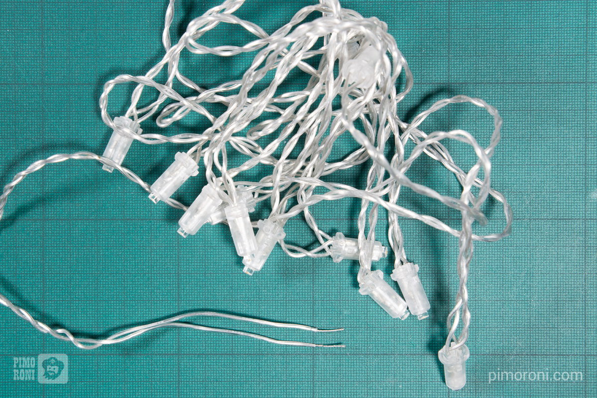

Using a small pair of snips, cut the two wires of each of the two sets of LED lights as close to the battery box as possible. Using a wire stripper, or carefully using the snips again, trim a good couple of centimetres of the insulation off each of the wires and twist the strands together.
Stripped LED wires

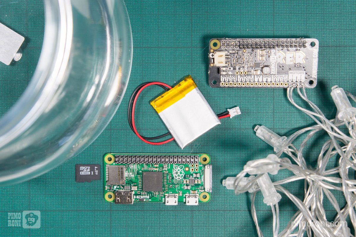

Putting it all together
Pieces
Plug your Explorer pHAT/LiPo SHIM board onto your Pi Zero and insert a micro-SD card with the latest version of Raspbian on it.

Pop the whole lot into your jar and your firefly light is complete!
