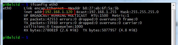

ifconfig eth0
Find your Pi IP.
The result of this command should be a glut of text and numbers, most of which we can ignore. The bit we're looking for is the group of numbers immediately following "inet addr".
