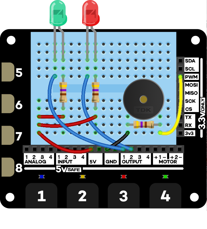

Connecting the components up
The wiring diagram is shown below.
Make sure that you connect the LEDs up the right way round, with the long leg - the anode - connected via the resistor to the 5V supply and the shorter leg connected to the output channel. The resistors connected to the LEDs are voltage-limiting resistors and reduce the 5V supply to a safe voltage for the LEDs. The piezo buzzer and the resistors can be connected up any which way you'd like.
Explorer HAT Pro pin entry

Setting our PIN
correct_pin = [1,2,3,4]
pin = []
We create list with the correct PIN that we want to match, and an empty list to which we can add the entered numbers. Whenever four digits have been added, we'll empty this list.
