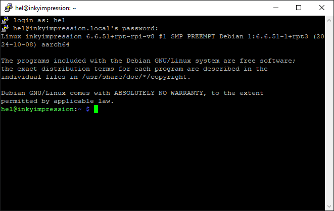

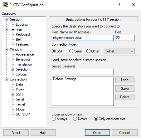

First we'll need to find a cover to display (we enjoyed this one, but you do you). Right click the image and copy the URL. Then, fire up your SSH client (we're using Putty) so you can run commands in your Pi's terminal:
Once you're connected to your Pi, run the following command to download the image to your Pi, substituting a different image URL if you wish:
wget https://comicvine.gamespot.com/a/uploads/scale_large/0/229/163489-18944-112530-1-weird-science.jpg -O comic.jpg
🎩 Top hat top tip: You can right mouse click in Putty (and some other SSH clients) to paste information stored in your computer's clipboard.

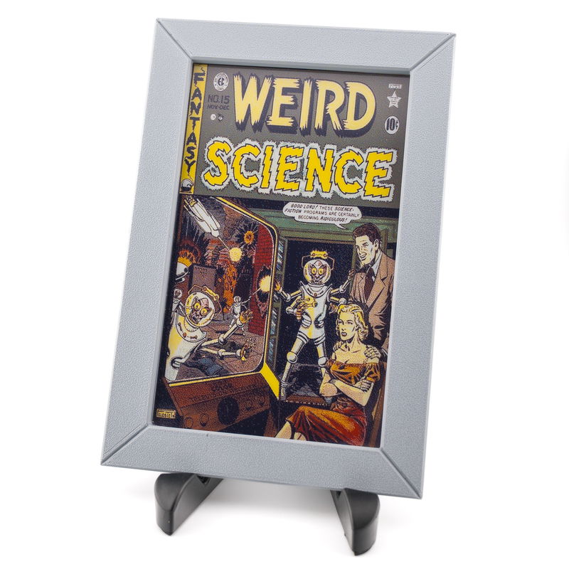

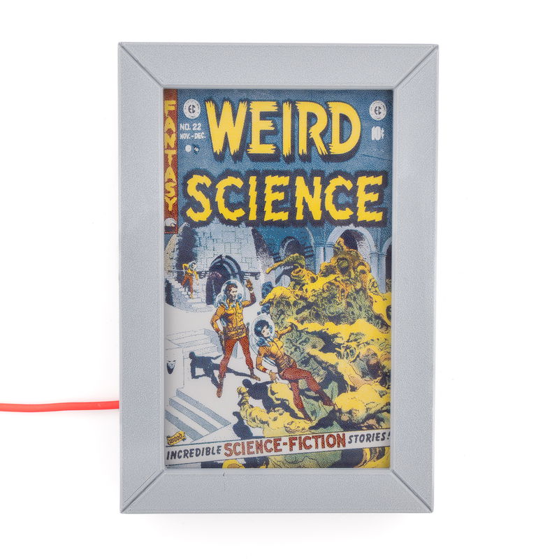

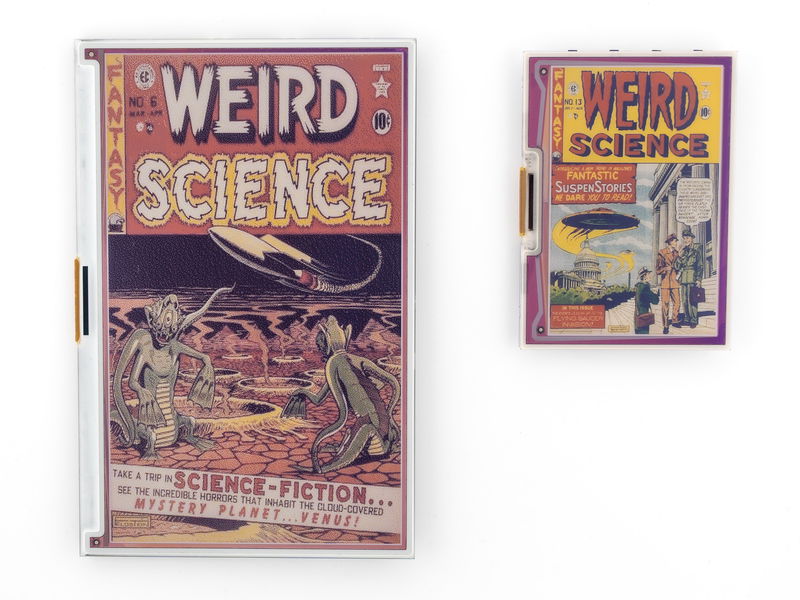

Here's the code above running on a 7 colour 7.3" Impression, and a dinky 7 colour 4" Impression.

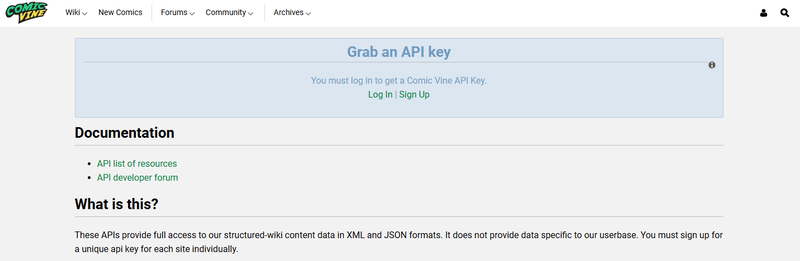

To run this code yourself, you will need to sign up for a Comic Vine account at the link below:
Once you've signed up and logged in to your account, you'll see your API key in the blue box at the top of this page. It's a long number so we'd suggest copying it to the clipboard.

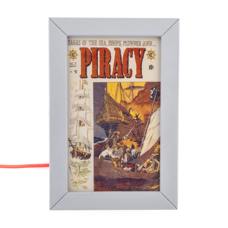

Perhaps you would like to search for your own favourite comic book series, or pick from a pool of a few different ones? Just open up the code in nano again, and edit the SEARCH_QUERIES list to add (or remove) search string/s. Your list of series should be seperated by commas and look something like this when you're done.
SEARCH_QUERIES = ["Weird Science", "Weird Fantasy", "Weird Science-Fantasy", "Piracy", "Tales of The Unexpected"]

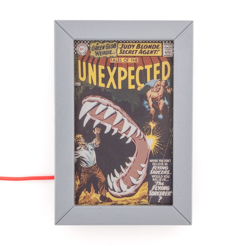

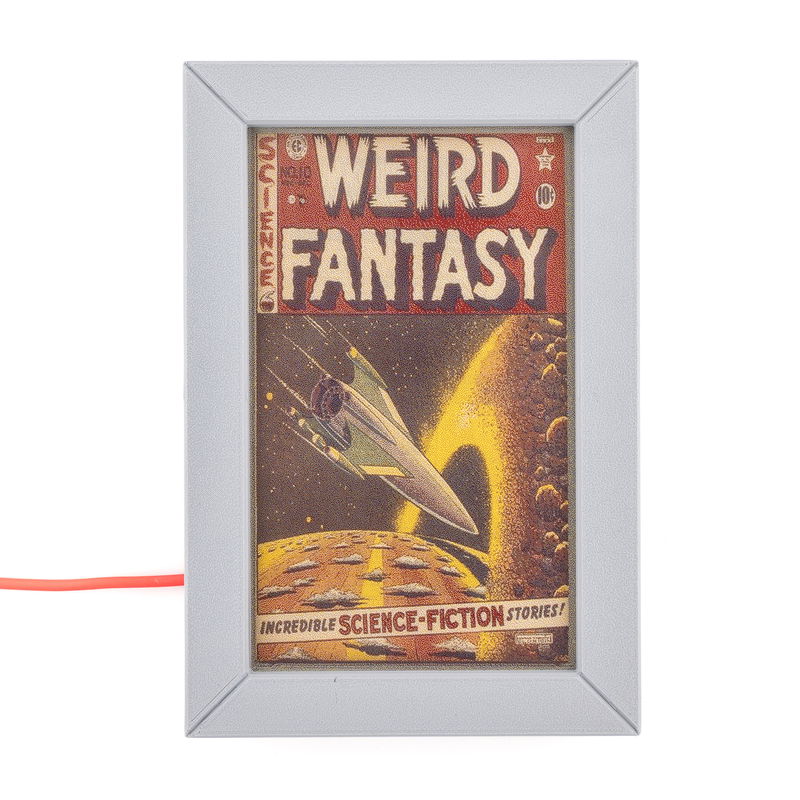

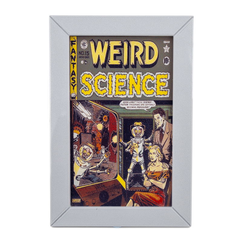

Adding a 3D printed frame

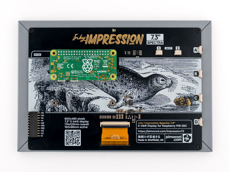

To make our Inky Impression look a bit more like a picture frame, we 3D printed a simple frame to make the bezel the same distance around the screen on all sides. If you'd like to do the same, you can find our 3D printing files at the link below:
We used M2 3mm bolts to fix it in place. The holes in the frame aren't threaded, but PLA is soft enough for the bolt threads to grab in place. This method might not hold up to multiple unscrewings though.
Once the bezel was attached, we used a Folding Tablet Stand to prop up our bezelled Inky.
