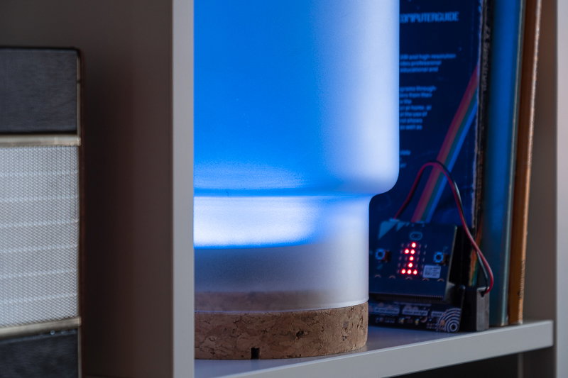

We put the micro:bit with the ZIP Halo on inside an IKEA Sinnerlig glass lamp, after taking the original bulb and wiring out, and it makes a lovely mood light. We used battery packs to power both the ZIP Halo micro:bit and enviro:bit micro:bit, so the whole thing is wireless, but you could easily use wired power supplies for a more permanent solution.

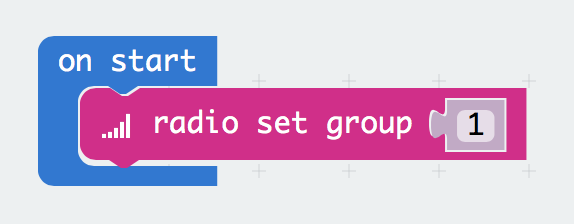

Setting up the radio
The micro:bit has a built-in radio function that lets you send commands from one micro:bit to another, and you can even send different commands to particular micro:bits by assigning them to different groups.
Let's set the radio up on micro:bit #1 to let it send commands to micro:bit #2.
  1. From the Radio menu, drag out the block radio set group and place it under on start

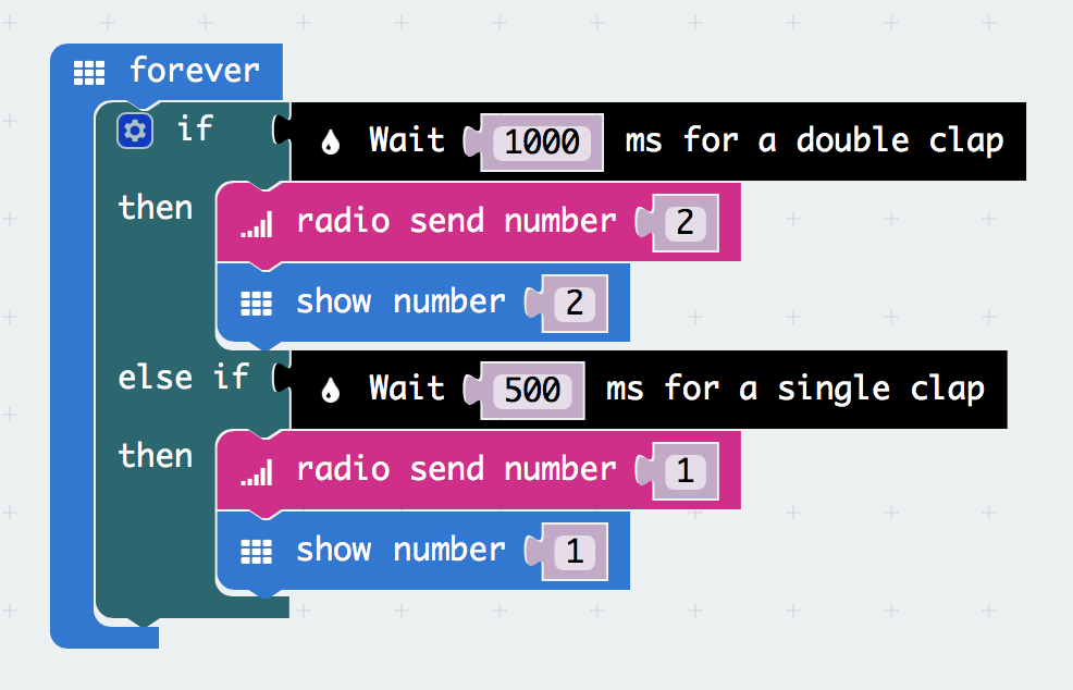

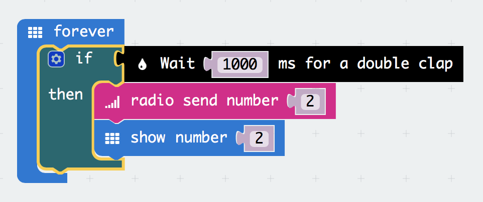

Let’s check for a double clap first. If we hear a double clap, we'll send the number 2 to micro:bit #2. The double clap will turn the light off.

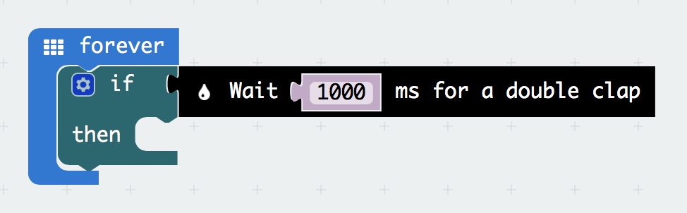

  1. From Logic, drag out if true then and put it under forever
  2. From Enviro:Bit, select Sound, drag out Wait 1000ms for a double clap and drop it onto the true
For a double clap, let’s send 2 to micro:bit #2 and also display 2 on the LED matrix on the micro:bit so that we can see better what's happening.
  1. From Radio select radio send number
  2. Change 0 to 2
  3. From Basic, select show number
  4. Change 0 to 2
Check for a single clap

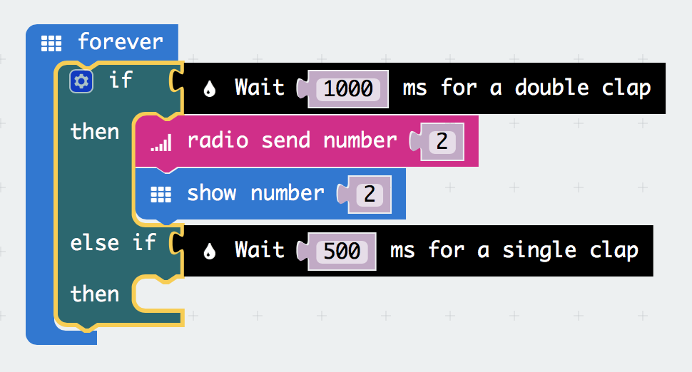

If it’s not a double clap, let’s check for a single clap and send the number 1 to micro:bit #2.
  1. Select the blue toggle on the if statement and drag else if under the if statement
  2. Select the blue toggle again to turn it off
  3. From Enviro:Bit, select Sound, drag out Wait 1000ms for a single clap and drop it onto if else
  4. Change 1000 to 500
For a single clap, let’s send 1 to micro:bit #2 and also display 1 on the LED matrix on the micro:bit.
  2. Change 0 to 1
  3. From Basic select show number
  4. Change 0 to 1

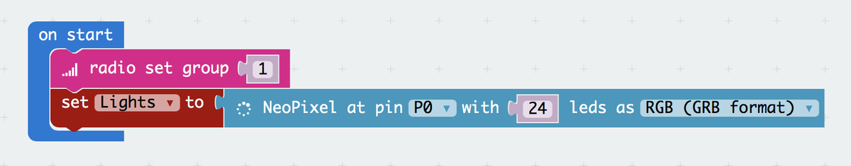

Let's set the radio up to allow it to receive commands from micro:bit #1.
Setting up the lights
We need a variable that we'll set to control the lights. We'll give it the very clever name of… Lights
  1. Create a variable called Lights
    1. Select Variable
    2. Select Create New Variable
    3. Type Lights and click OK
  2. From the Variables menu, drag out Set item to 0 and place it under On start
  3. Change item to Lights
  4. From the NeoPixel menu, select the first block NeoPixel at pin 0 and drop it onto 0
  5. If you're using different NeoPixel lights, change 24 leds to the number of LEDs that you have

We used a couple of lumps of Blu Tack to attach the battery pack and the ZIP Halo to the base of the IKEA Sinnerlig lamp, and then popped the glass cover back on.
