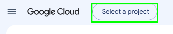

  2. In the top left of the screen click on Select a project. We need to create a project so that we can use the YouTube API.

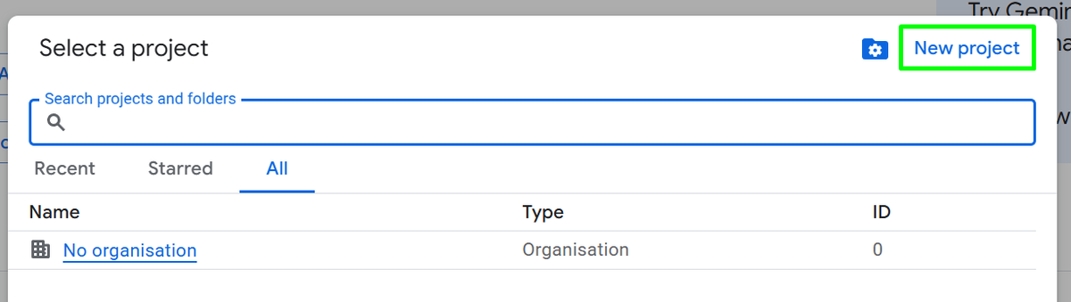

  3. Click on New project.

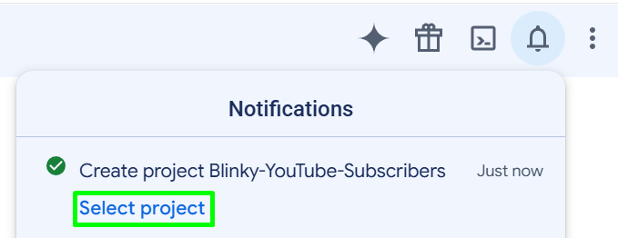

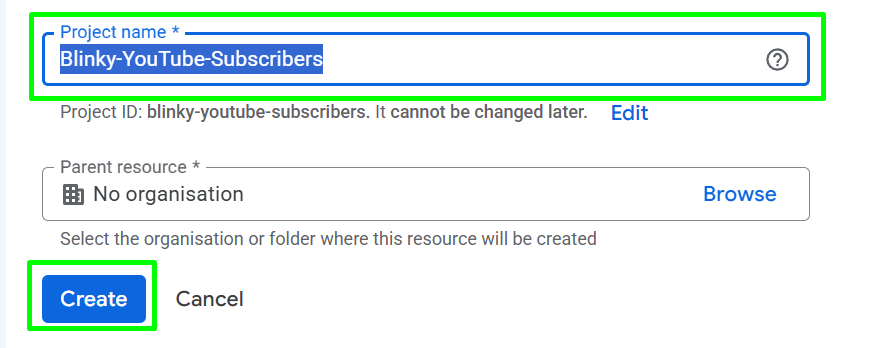

  4. In the next window, call the project Blinky-YouTube-Subscribers and click Create. There is no need to create an organisation but you can if you wish.
  5. Under Notifications click on Select project to start using it.

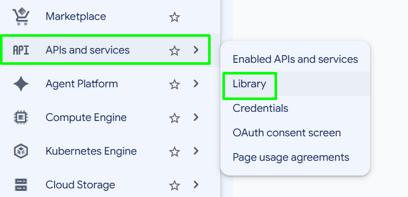

  6. In the left hand menu, under APIs and services click on Library.

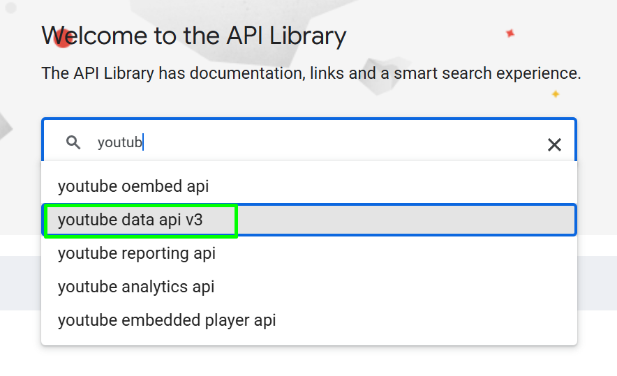

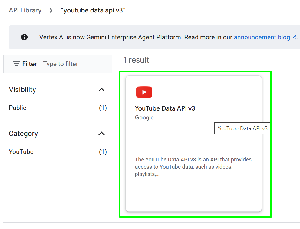

  7. In the library, search for YouTube Data API v3 and select it. You will only need to type in a few letters before the suggestions kick in.
  8. Click on the YouTube Data API v3 result card to enter its product details (configuration) page.

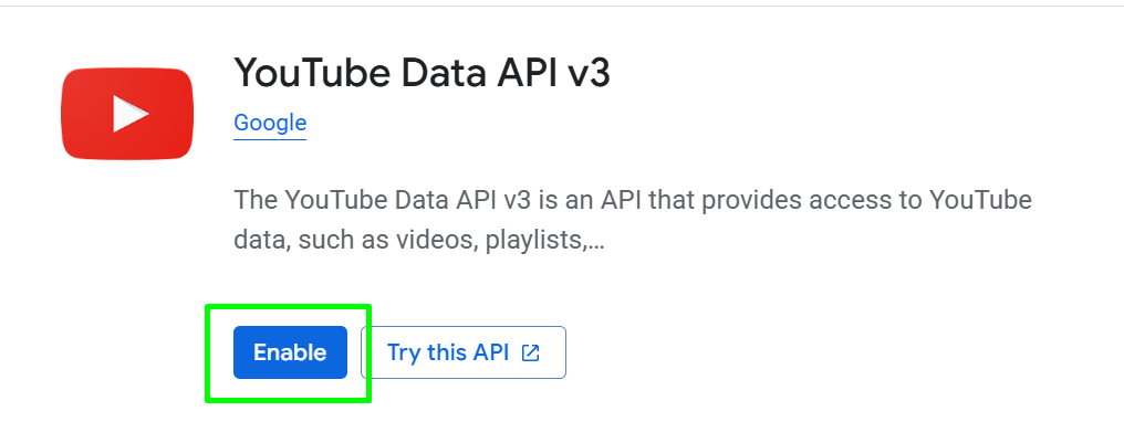

  9. Click on Enable to start using the API.

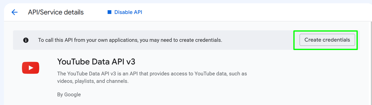

  10. Click on Create credentials to start the process of creating an API key.

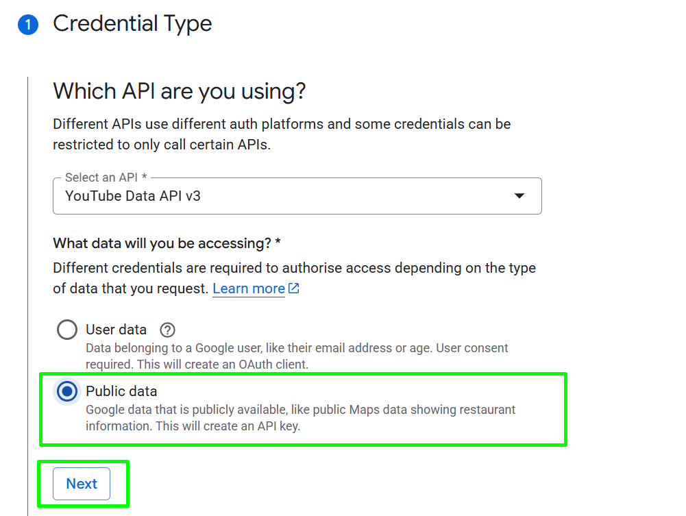

  11. Select Public data and click Next.

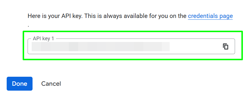

  12. Copy your API key and paste it into a text file for later use. Click on Done when ready. Do not share your API key with anyone, or save it to a public repository.

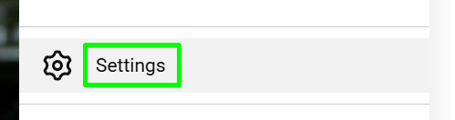

  2. Click on Settings.

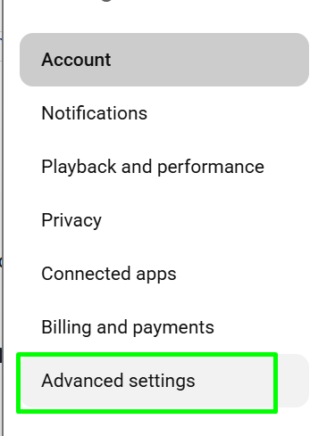

  3. Select Advanced settings.

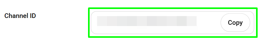

  4. Copy your Channel ID and paste it into a text file for later use. Do not share your channel ID.

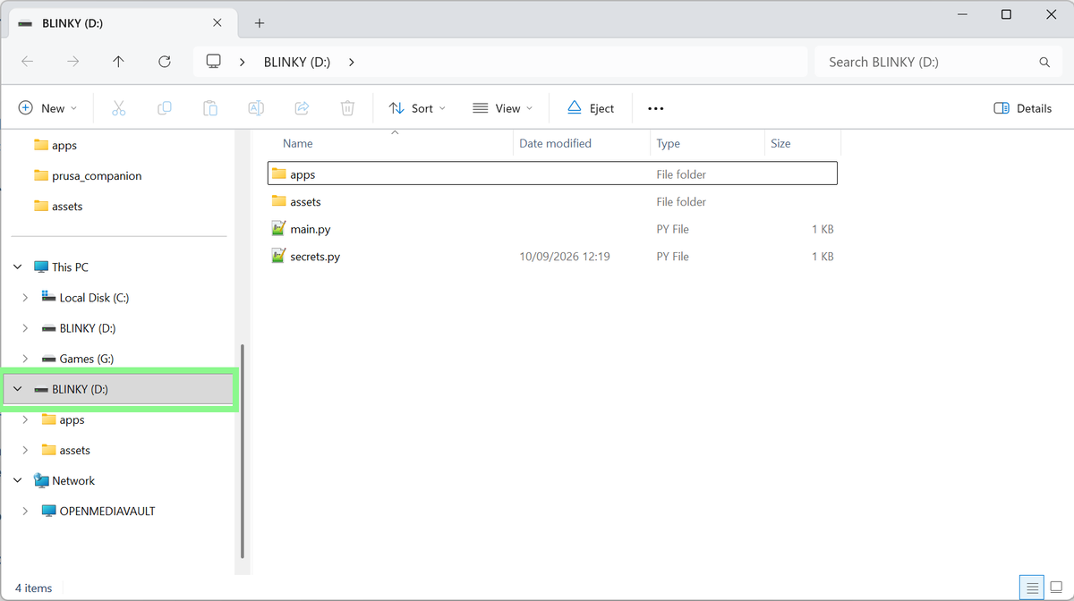

  1. Connect Blinky to your PC and press RESET twice to enter USB drive mode. Your PC will treat Blinky just like a typical USB flash drive.
  2. Open your operating system's file manager and navigate to a drive called BLINKY.

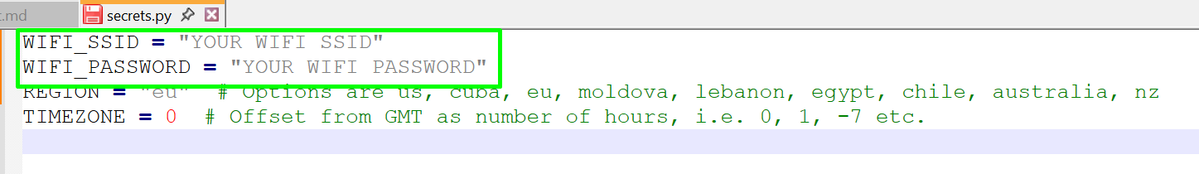

  3. Open secrets.py in a text editor and enter your Wi-Fi SSID and password in the WIFI_SSID and WIFI_PASSWORD constants.

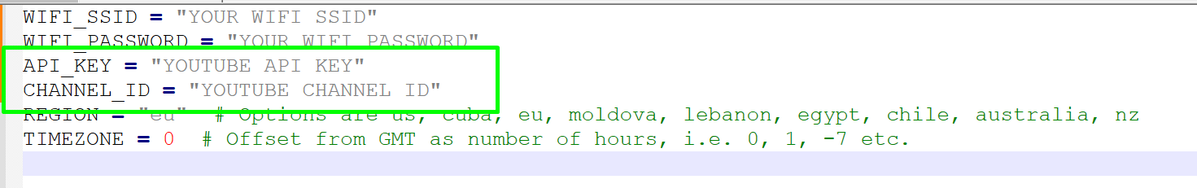

  4. Create two new lines in the file and enter your YouTube API key and channel ID then save and close the file. We are creating two constants for the API_KEY and the CHANNEL_ID.
    API_KEY = "YOUR YOUTUBE API KEY"
    CHANNEL_ID = "YOUR CHANNEL ID"

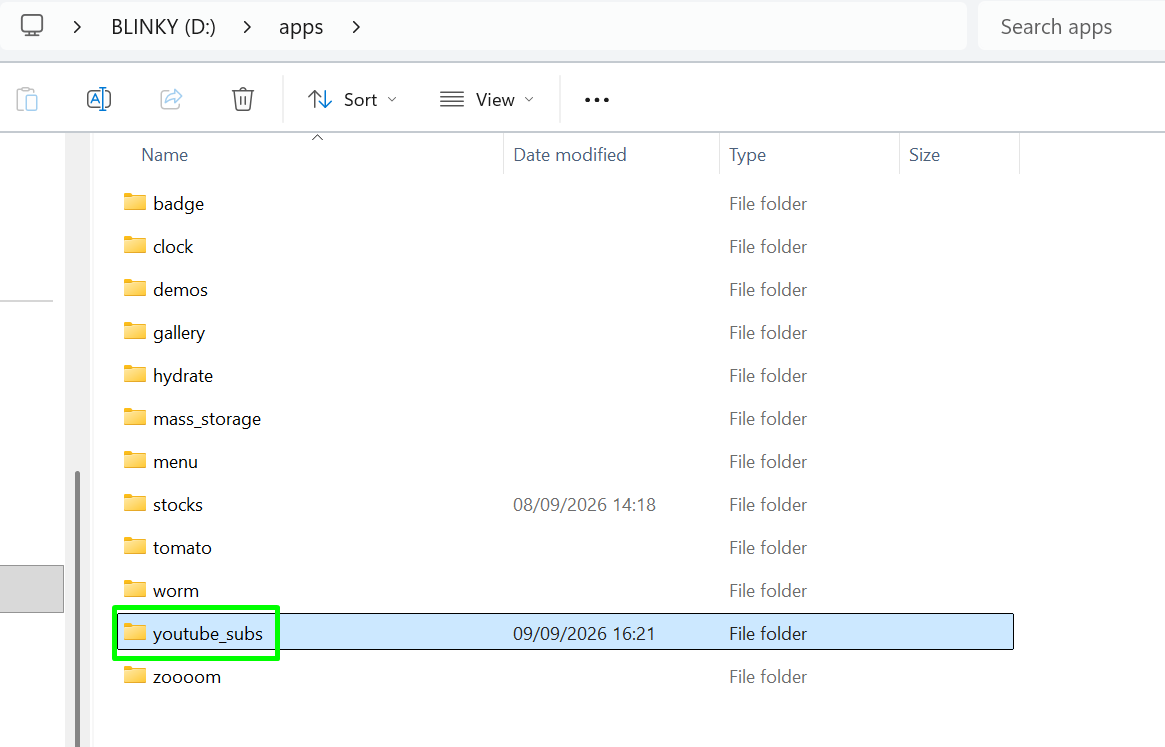

  5. Inside BLINKY drive, open apps and create a new folder called youtube_subs to contain our app.
  6. Open the youtube_subs folder and create a new folder called assets. In here is where we will store an image used in the app. Here is the image for you to download.

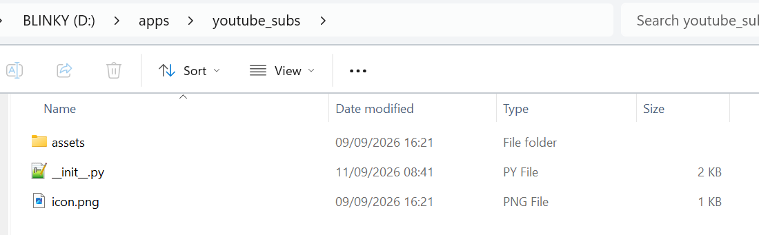

  7. Inside the youtube_subs folder, and not assets save this file as icon.png.
  8. Open your preferred text editor (we are using Thonny) and in a new blank file, we start coding the project.
  9. Save the blank file as __init__.py inside the youtube_subs folder. You should now have a youtube_subs folder identical to this.

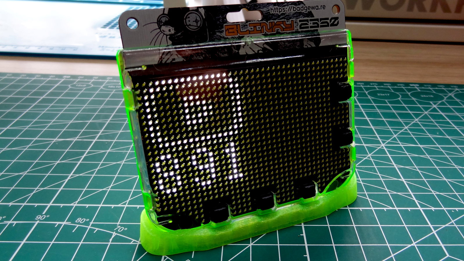

  8. Save the code and press RESET on Blinky to restart in badge mode,

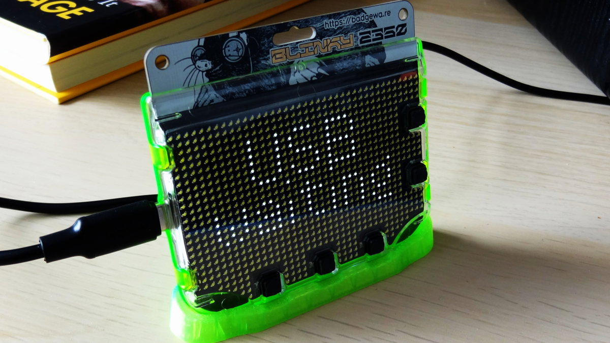

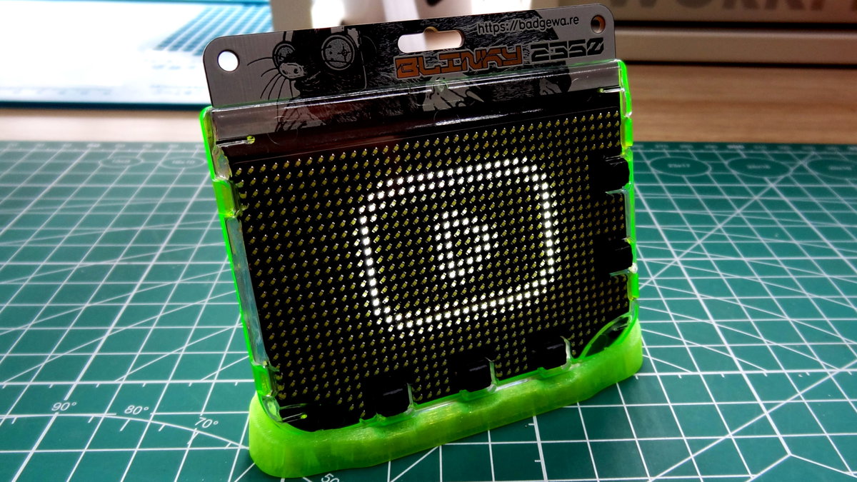

  9. Scroll to the app, you should see the YouTube logo bounce on the screen.
  10. Press B to start the app. The case lights will flash until a solid Wi-Fi connection is made. Once connected, an API call is made and after a few seconds we will see the details on Blinky's display.
