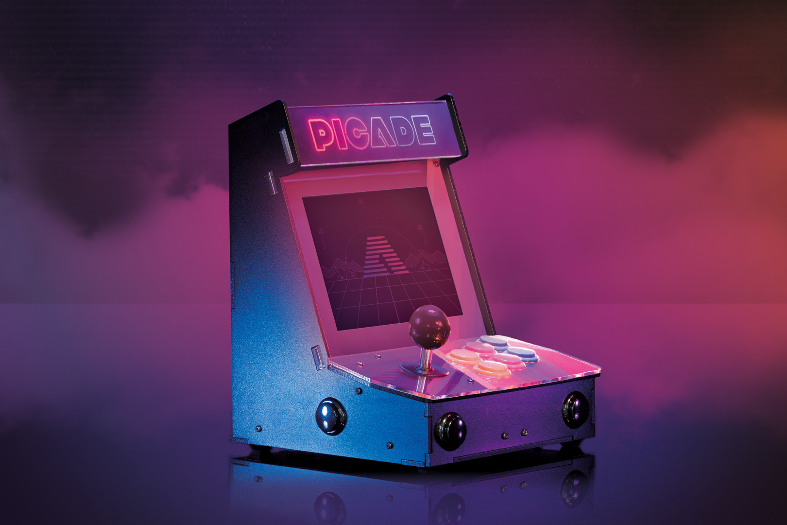

Assembling your Picade - 2020 edition
This tutorial will help you assemble your 8" or 10" Picade, 2020 edition with PICO-8. It will also show you how to install Retropie and our Picade HAT software.
Old tutorial awooga! This tutorial is not for our most recent Picade edition - check out the Picade shop page for a link to the most up to date instructions.
Checking your Picade version
It is a good idea to double check that you're following the correct assembly guide before you continue. Take a look at your Picade box. If you have a 2020 edition Picade, it will look something like this - note the square PICO-8 sticker and the green 'new for 2020 / USB-C' sticker.
You can also identify a 2020 Picade from its console and marquee artwork - the art has curvy lines and looks like this:
If the box doesn't have a PICO-8 sticker, and your console and marquee artwork looks like this then you should follow this tutorial instead.
