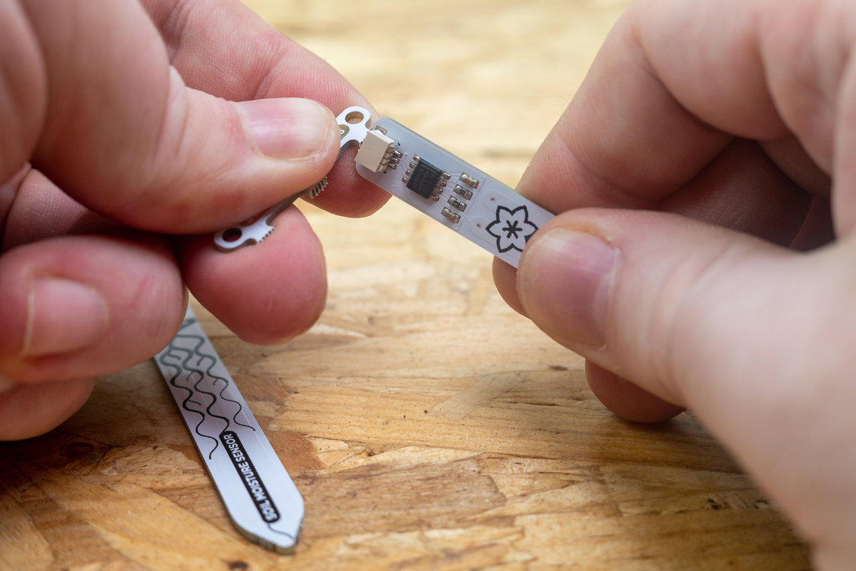

The moisture sensors come in sets of three, still attached to their sprues. Side cutters are the best way to separate them if you have them, but snapping them by hand along the perforation line will work too. You can tidy up the rough edge with sandpaper or an emery board if you want.
Removing the moisture sensors from their sprues

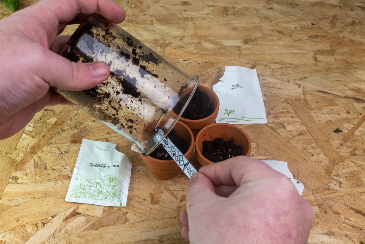

For the capacitive moisture sensors to work best as much of them will need to be surrounded by soil as possible, so it’s best to position the sensors a little way in from the edge of the pot and push them in as far as they can go. The Under/Ground line should be at or above the level of the soil, to avoid the components at the top of the sensors coming into contact with water.

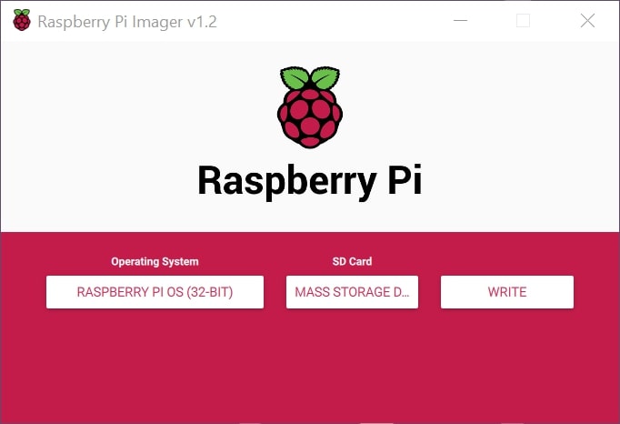

We recommend flashing the OS to your SD card using the Raspberry Pi Imager tool, which is available for Windows, Mac and Linux - you can download it here. There are detailed instructions here if you need them.
Screenshot of Raspberry Pi imager program

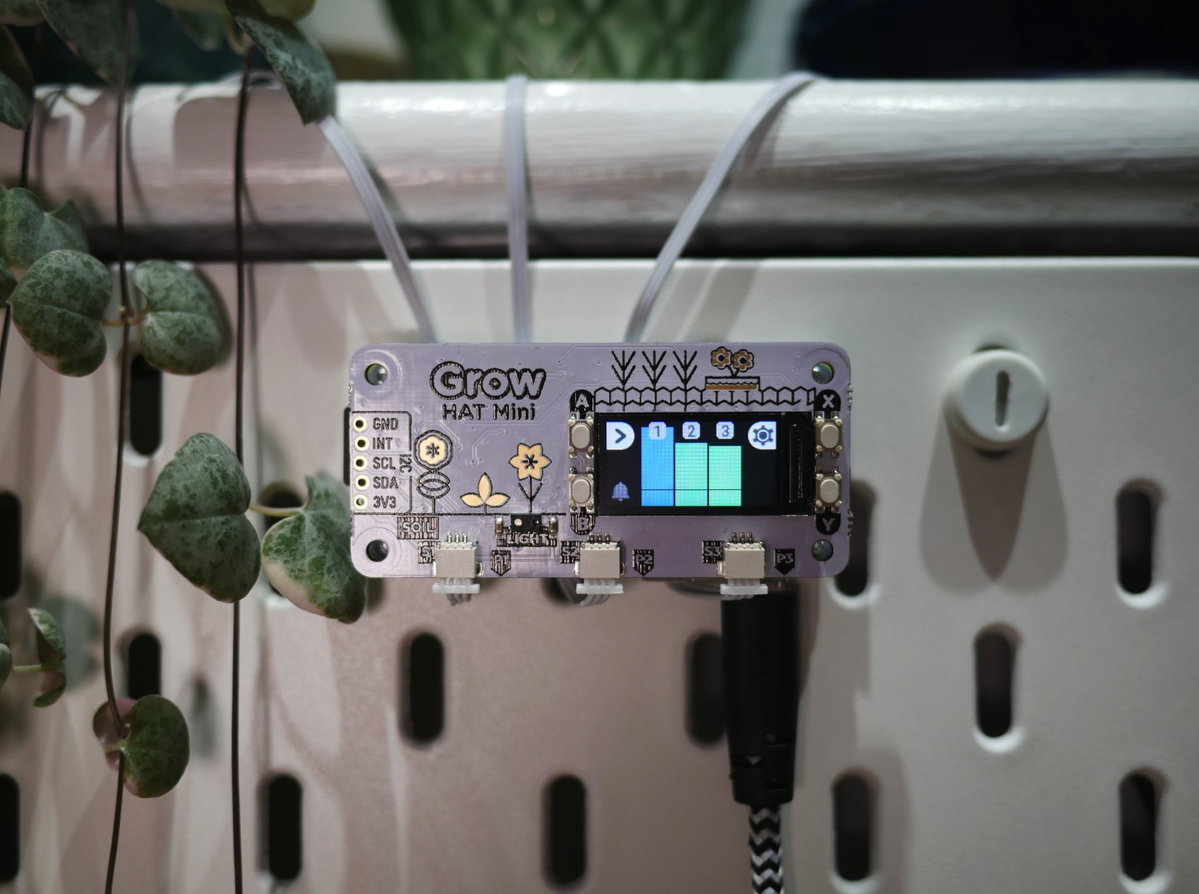

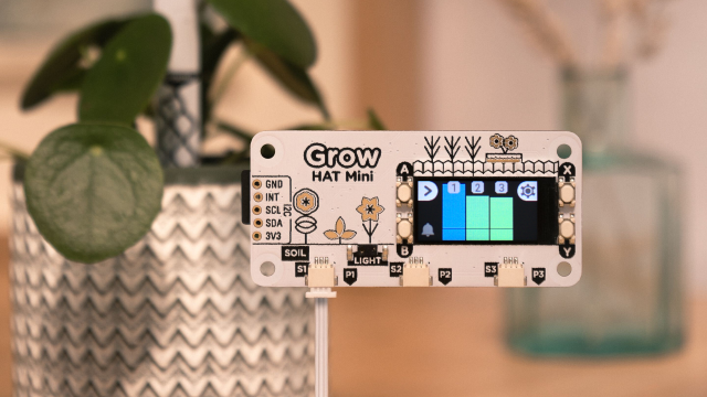

Once you've rebooted, if everything's gone well you should have a screen that looks something like this (though your lines and bars are likely to be in different places!)
Main screen of Grow HAT Mini UI
You’ll see three bars that correspond to your three moisture sensor channels, the colour and height will show you how hydrated each of your pots is, and the black line will show you at what level the alarm will sound. The button next to the little bell will mute the alarm if it’s going off, the alarm will also auto-mute if the light sensor detects it’s dark (so it shouldn’t chirp away at night!) The > (A button) at the top left will cycle through the channels and show you more information about each one, as well as a little graph showing the moisture levels over time.

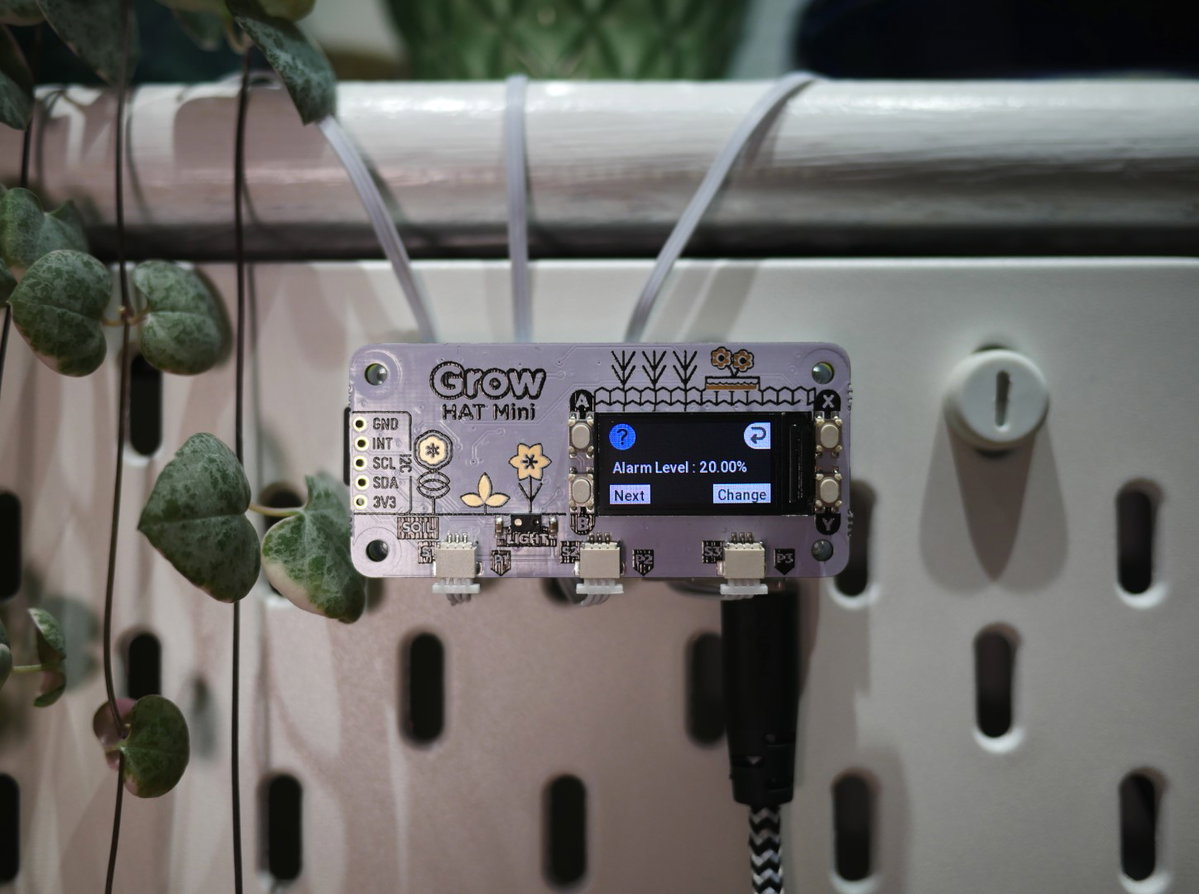

The % is the current moisture level of your pot, or saturation. The settings button (X button) within the channel menu will take you to a screen where you can alter the moisture level at which the alarm is triggered, or disable the channel altogether. You can also alter the wet and dry points using this screen - more on how those work in the calibration section below!
Channel settings of Grow HAT Mini UI

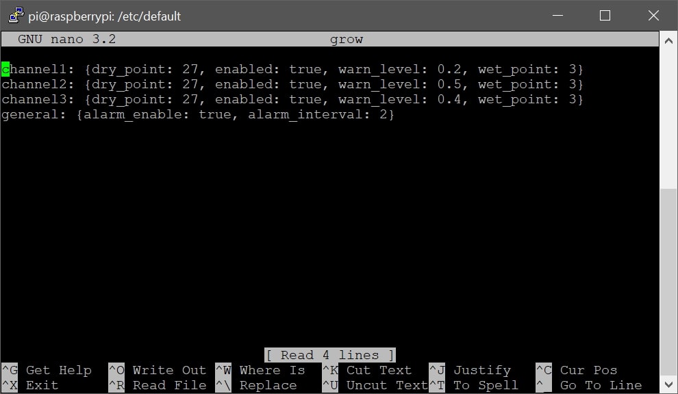

Any of the settings that you change in using the menus in the monitor will be saved in a file on your Pi, which will look something like this:
Screenshot of settings file in Nano text editor

If you’re running the monitor as a service and want to edit your settings file directly you can do that with:
cd /etc/default
sudo nano grow
(and ctrl-X to exit Nano when you're done editing). It's a good idea to stop the service before you start editing the settings file, and start it again afterwards.
