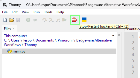

  2. Click on Stop to force Thonny to reset the connection the Badgeware device. Thonny should auto-detect your device. If not, got to Tools >> Options >> Interpreter and select Raspberry Pi Pico and for Port set it to Auto. Then, retry.

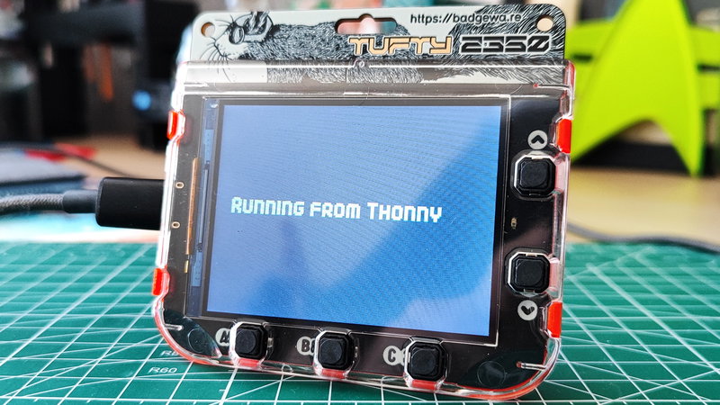

The test code for this tutorial is intentionally simple. We just want to write a message to the screen. The same process can be used to develop full applications with images and interactivity. With that in mind, the project code is as follows.
  1. Create a function called update.
     def update():
  2. Inside the function, set the pen colour to navy, and then clear the screen. This will set the background colour of the screen to navy blue.
         screen.pen = color.navy
         screen.clear()
  3. Set the pen colour to white and then select the Smart font. This will set the text colour to white and change the font into something pretty.
         screen.pen = color.white
         screen.font = rom_font.smart
  4. Write a message to the screen. Here we set the position to be 10 pixels in from the left side, and 50 pixels down from the top of the screen.
        screen.text("Running from Thonny", 10, 50)
  5. Run the update function.
    run(update)
  6. Your code should look like this.
    def update():
        screen.clear()
    run(update)
  7. Save the code to your computer as main.py. Saving code as main.py will force MicroPython to run the code when the board is powered up. In this quick example we are certain that everything will work. When developing your project code, save it as something else, test.py etc, until you know it works. A malfunctioning main.py can lock up your device, and require a firmware reflash.

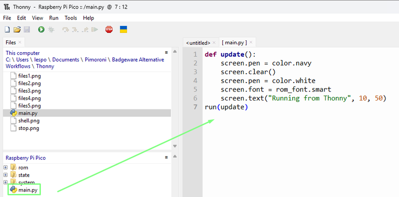

  4. Right click on main.py and select Upload to /. This will copy the file to the filesystem root of your Badgeware device. This can also be used to copy directories from your computer to Badgeware devices.
  5. You should now see the file copied to the Badgeware device.

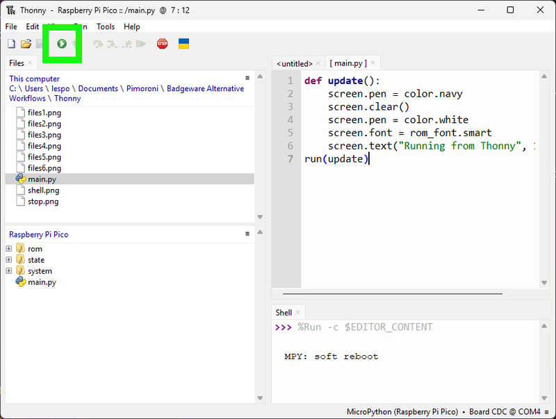

  6. Double click on the Raspberry Pi Pico copy of main.py to open the file in the editor.
  7. Click on Run (the green play button) to run main.py on your Badgeware device.
  8. The Badgeware device's screen should now show the text "RUNNING FROM THONNY".
  9. Stop the code by pressing the Stop button in Thonny, or you can reset the Badgeware device.
You can now develop your Badgeware projects interactively with Thonny. Any errors or code output will be sent to Thonny's Python Shell, while the Badgeware device runs the code and displays your project.

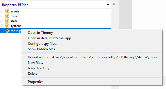

Thonny filesystem commands
Right clicking on a file or in a directory inside of Thonny's file manager, will bring up a menu where we can:
  • Open a file in Thonny.
  • Open in an external application.
  • Configure Python files.
  • Show hidden files.
  • Download the file(s) / directory to your computer.
  • Create a new file.
  • Create a new directory.
  • Delete a file / directory.
  • Get the properties for a file / directory.
These options are helpful when we need to work inside the Badgeware / MicroPython devices filesystem.

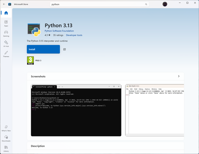

  1. Install the latest version of Python - at the time of writing this was Python 3.13. As we are using a Windows 11 PC, we are installing via the Microsoft Store as it automatically sets up the path config necessary for the upcoming steps. Linux users: Python typically comes pre-installed, but you can check by opening a terminal and typing python, you should see the Python shell appear. If not, install Python as per your distribution's instructions.

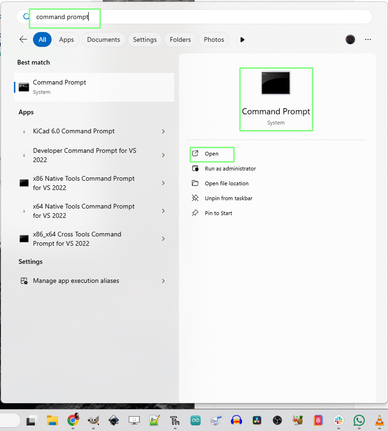

  2. Open a Command Prompt. In Windows 10 and 11 we can search for Command Prompt. Linux users, open a Terminal.

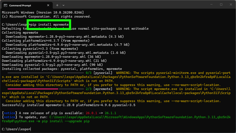

  3. Use pip to install mpremote. pip is Python's built-in package management tool. Installing mpremote via this method ensures that the tool is accessible from the Command Prompt / Terminal.
    pip install mpremote

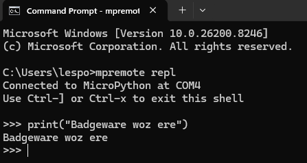

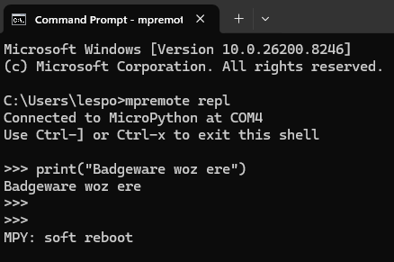

  4. In the Command Prompt / Terminal, use mpremote to check that you can communicate with the device by opening a REPL (Read, Eval, Print, Loop) Python shell.
    mpremote repl
  5. Press CTRL + C in the REPL to stop any running code and to enable input. Here you can see that we wrote a line to print "Badgeware woz ere".
  6. Press CTRL+D to reboot Badgeware, then CTRL + X to exit the mpremote session.

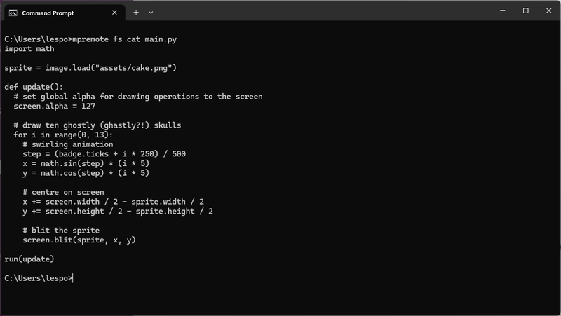

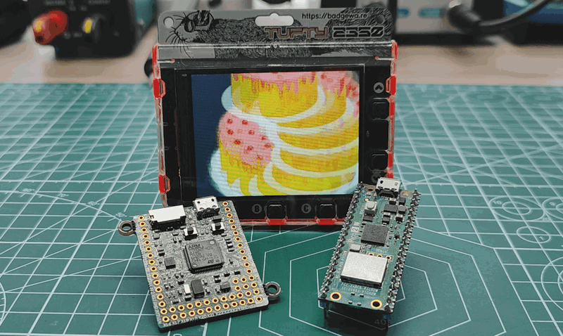

We'll be using this Badgeware alpha blending example as a way to demonstrate how to use mpremote to copy and run code remotely on your Badgeware device. The code will show a ghostly birthday cake, spiralling from the centre of the screen.
import math
sprite = image.load("assets/cake.png")
def update():
  # set global alpha for drawing operations to the screen
  screen.alpha = 127
  # draw ten ghostly (ghastly?!) skulls
  for i in range(0, 13):
    # swirling animation
    step = (badge.ticks + i * 250) / 500
    x = math.sin(step) * (i * 5)
    y = math.cos(step) * (i * 5)
    # centre on screen
    x += screen.width / 2 - sprite.width / 2
    y += screen.height / 2 - sprite.height / 2
    # blit the sprite
    screen.blit(sprite, x, y)
run(update)
You will notice that there is an image asset.
We will need to upload a directory containing the image file using mpremote. This version of the code can be downloaded as a ZIP archive via my GitHub repo.

  3. Use the cp command to copy the files to the device. The syntax is, command, source file, destination. In this case the destination is the root of the Badgeware device.
    mpremote cp main.py :/
  4. Copy the directory using cp -r. Here we copy the assets directory. Without the -r switch, the copy will fail with a permission denied error.
    python -m mpremote cp -r assets/ :/
  5. Remotely run the code on the device.
    python -m mpremote run main.py
  6. Check the Badgeware device, you should see the code running on the screen.
  7. Press Reset on your Badgeware device to stop and reset the device. The code will continue running even if we press CTRL + C or CTRL + D.

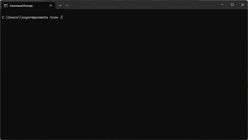

Print a directory tree.
tree [-vsh] <dirs>
